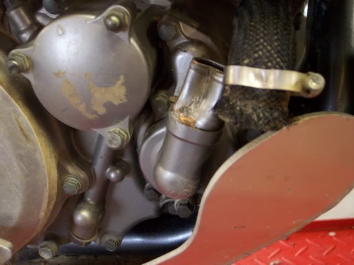

drz water pump smashed, 70+ miles no water?
Here is a pic of the water pump housing on my drz400, This had to happen on a previous ride when I droped it big time, I then rode rest of that day (another 30 miles), then another 54 mile ride last friday. I didnt notice it until now, or I woudlnt have rode last friday.
I took the hose off, and no water came out, so I poured some in the top of radiator and it came out the bottom, so theres NO WATER in the radiaotr, or at least this side? could there possibly still be water in the other side that kept it cool on the 54 mile ride? there is a little coolent in the overflow tank.
I rode it 54 miles last friday, and it's still running.. Looks like if there is no water in it, teh motor would have seized up? should I be concerned? anything i should check, other then replacing the housing, and filling it back up with coolent? is it possible the other side of radiator has coolent in it or had coolent in it? or if this side is empty, should I assume the other side is empty also?

Did you look at the oil to see if its all milky? I have heard stories of people running their drz's without coolant to get out of the woods and not having any trouble. You may be ok. I would replace the water pump cover and check to see if you are getting proper flow. Also make sure you don't have the milkshake oil or white smoke billowing out the exhaust.
Just drained the oil, didnt see anything that looked milky. I rode it 54 miles friday and didnt notice any white smoky out of exaust, I'll check it once I get it put back together tho..
Tho on the day the wrecked happend, and I'm guessing when this happend, but not for sure, later on that day, I was notice a weird noise in the motor when it was under extra strain, otherwise didnt notice it. Then didnt notice it friday when we rode, but was on fairly easy ride friday.

I hope it'll be ok, big difference in 5 miles and 75 miles (54 mile ride, plus another 20 miles that one day). I asked the guy who followed me friday if he saw any white smoke, he said he thought he did see a little from time to time. So I dunno. Ordered parts from ronayers, so have to wait on them to get here, then just put it back together and see if it's smoking any. If it is, dunno what my next step would be, I guess replacing rings, which didnt use to be an expensive job, but dunno about todays rates. I'll post results after I get it back together. If it's still running great after that, its one tuff motorcycle I must say.

i would bet that the weird noise under strain was the sound of the engine knocking/pinging due to detonation. Since your engine was probably running on the hot side it would be predisposed to preignition and detonation. Its possible you might have incurred some piston damager. You could try to get your hands on a boroscope and have a look at the top of the piston...or you could just change the oil and filter, and replace the pump cover and fill it back up and ride.
If you have any big trips to the middle of nowhere planned you might want to double check the piston condition with the scope.
I asked a guy about the noise when it was happening, and at the time I didnt know I had the damaged water pump inlet, he said it was probably a spark knock, and nothing to worry about. Guy riding with me was on a CRF450X, and said his makes alot of weird noises as well, and its nearly new. If I hadn't rode the 54 mile ride after that, I would feel better about it. But on that ride, I didnt hear any such noises, or anything, but it was a failry easy route, compared to the one we did the other ride.
I called my mechanic, and he recommended just putting it back together and if it runs ok and no smoking, just ride it. I dunno if he has a boroscope, but I'll ask him, maybe get him to do a compression test on it ? dunno if u can do that w/o tearing it down or not? If I see any smoke at all even if just a little bit when I put it back together, I'll probably get my mechanic to tear it down and replace rings, and look everthing over.. Just for peace of mind.
Python423 is offline   Reply With Quote

its probably ok. Most motorcycles dont knock/ping/preignite to the point of any real damage because of the load ratio of engine to weight of bike/rider. However in a 2 litre turbo charged car you can have some serious issues...like melted, shattered, and holes through pistons...but there you have a lot more load and much more likelyhood of a problem.
It may well be okay.
I cracked that same area bouncing off of some rock somewhere next to the trail (not even a crash, but noticed the coolant smell shortly thereafter). I poured the contents of my Camelbak into it but it just poured right through. I rode home as gingerly as possibly, though I needed to get out of the deep woods first so rode a few miles of tight trail (hard on cooling) and then 15 miles home.
Afterwards I had slight coolant leak for a while as I theorize the heat disturbed the shaft seal. I was about to try the "RTV fix" when the leak stopped by itself.
You went an unusually long way on yours. No, coolant can't stay in one side radiator and not the other, the same coolant pumps through both. It is probably okay. So fix the cooling system, change the oil if it makes you feel better, keep riding and see if there is anything wrong.

The way I would approach this seems to go against the grain. I would change/refill the fluids after the repair. Then I would do two different cooling system pressure tests. Your mechanic friend should have a cooling system pressure tester.
The first test is just a simple leak test. Pump it up and wait 5 minutes while you look for leaks. If it leaks down fix it and retest. In your situation there could be internal damage, so if it leaks down be sure to justify the leak. It could go into the cylinder or the crankcase, which won't be obvious from a visual on the outside.
The second test is a "combustion to cooling system test". With the coolant full pump the system up to about 2 psi. Disable the ignition and crank the engine for 10 seconds. If the gauge on the tester pulses and climbs then you have a problem.
For me these two tests, which can be performed by any mechanic with the test equipment for .5 hours of labor, would be a huge piece of mind. For me it beats finding out that there are greater cooling system issues 20 miles out in the woods.

you won't have white smoke until the engine is warm and full of coolant, then it makes cooling system pressure and would force it into the combustion chamber if there is a problem. like some of the others said, i would change the oil and fix the waterpump and refill with coolant. ride and see if it is ok. be sure there isn't any white or blue smoke. cylinder damage from overheating will cause the engine to use oil even if it doesn't use coolant and oil smoke is blue. coolant smoke is white and fuel is black. it's amazing it ran that long with no coolant maybe just call it an airhead now?
