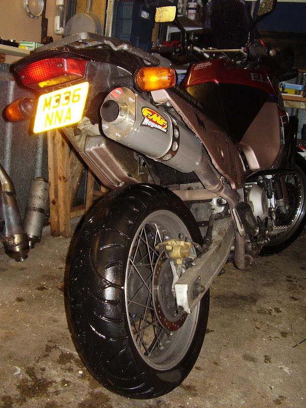

Hi Mr G Funk,
as far as back wheel goes, i have a 160/60 on a 4.25 rim and it clears swing arm & chain. I have a slightly wider front rim and run 110/80. I've made these changes so i can run modern road tyres (BT020/1) and they work well.
if your running TKC80's then aren't you better off going down the 21" front and 18" rear route? how about going for same rim sizes as KTM 950? even the whole KTM front end.....anyone run this set up? any pics?
cheers
Andy
