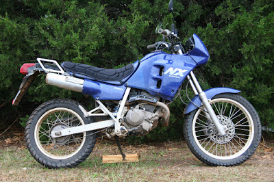

Once there was a nice little motorcycle. It had lived it's life pampered in a dry garage, thoughtfully cared for and maintained, and on the back of a motorhome. The first few years took Sweet Little NX to many campgrounds and small towns across the western states. The years past and the trips became fewer, until they stopped, and she stood still.
For a long, long time.
Then the owners got sick, and sold her off cheap to pay for more dialysis. Tearfully, she departed her owners company. Soon she came to a new garage next to house in which a family was growing, and that garage was full of intimidating gear and bigger bikes. They all teased her and called her names, but when it was time to break in the kids to riding, Sweet Little NX was there. She taught that a little fear is a good thing, and that knowledge, skill, and courage can overcome more than you had imagined. She was dropped a few times, but always picked right back up and brushed off thoroughly.
The bigger bikes liked the way the riders came to them, full of drive and ready to twist the throttle and fly through the woods, so they stopped laughing and let her 'ride the table' like the rest of them when it was time for fresh oil.
She was happy, but felt like something was missing. She was getting older and since the kids had grown she never got outside anymore, much less went on any adventures. Her second owners knew it was time to let her go, so an ad was posted, a transaction was handled, and a much longer-in-the-tooth Little NX was rolled onto a trailer and down the road.
Next to this house, there was no garage, carport or tarp. There was only a slab of concrete under a big red oak, with a white work truck full of tools to act as wind break.
The first few nights were cold and wet, sending chills through her antifreeze. Would this new owner let her rust?
When the rain cleared one night she could see through the blowing leaves of the tree thousands of stars shining down on her, like she had not seen in years.
Her new owner took the time to get to know her, and gently cleaned the parts that had been left alone for so long. He bought her a new CDI and dug into her electrical connectors. He dreamed of better dirt tires. He was getting her ready for something she was sure, but the short test rides among the pines thrilled her and brought back most of the youthful vigor she knew she still possessed. Even though she sometimes fell down, she felt alive again.
She wasn't breathing right, and as much as she was enjoying longer rides and tougher terrain than she had faced before, she had to hold something back. Her idle was very inconsistent, and sometimes would hang or race nearly out of control. Her owner lovingly cleaned her carb, but nothing seemed to help. She was getting dangerous to ride, and one day it caught up to her.
Coming around a sweeping gravel turn at about 35 mph, the rpms jumped, and the rider over reacted. Her front brake locked, and they both tumbled to a stop in a pile of broken glass and phalanges.
Sweet Little NX was badly damaged. Her faring was ripped off and thrown aside, her brackets bent and disfigured, the taillight was broken, the frame was tweaked, and her headlight...
...let's not talk about her headlight. Imagine the worst and you are very close.
She lay there with her ignition on, her life force draining away, while the rider slowly regained composure. He held his broken thumb and walked to her, reaching out to turn the key to off.
It was too late.
He lifted her to her wheels and steadied her against the tree they somehow avoided in the may-lay. He gathered her broken body parts and stowed them in the tailbag, he beat her pegs into usability with a rock, and he bent her rear brake lever to point in the right direction. He rested, and wished he had a partner on this ride.
He threw his leg around her, and squeezing half a clutch lever, he pushed her starter.
Silence. Deafening silence.
Then a jerk, a bump and twist on her throttle and she sprang to life as the concussed rider push started her back to consciousness and they limped out of the riding area and rolled slowly home.
Sweet Little NX was battered beyond casual recognition, and if she and the rider were to continue, drastic changes needed to be made.
Sweet Little NX died on the table that night, but The Six Million Dollar NX was born.
Exhaust removed and frame straightened...
Carb thoroughly cleaned, including the clogged right vent this time...
Air filter, oil, antifreeze, thermostat...
Carb to manifold o-ring...
Headlight bracket removed...
Mounting points ground from the steering stem...
Speedo/tach removed...
Custom wiring harness fabricated...
New battery...
Starter motor rebuilt...
Cr high bend bars, cut one inch on each side...
Tusk hand/lever guard...
Tank plastics cut down...
Polisport MMX headlight...
Acerbis SM front fender, stock fork brace...
Stock 19" front wheel with Shinko 244 2.75x19...
17" 84 xr350l rear wheel shod with Shinko 244 4.60x17 rubber...
License plate bracket fabricated with lights and markers from AutoZone...
Passenger pegs removed and stored in tailbag...
Stickers removed...
Parts acquired but not yet installed: 21" 84 xr350l front wheel shod with Shinko 244 3.00x21 and stainless steel front brake line with master cylinder fittings to allow more lever movement for standing.
Now she laughs as she flies down trail, re-born.
Life, and change, is good.

$18 ebay wide pegs, no springs...
Ugly but comfortable Sterns ATV seat pad...
Clutch and throttle cables...
Rear brake rod up top...
I'm about to throw down $225 for a custom SeatConcepts seat, and
if I find a fork brace I like I may go 21" on the front.
I had trouble with the 17" rear when I had a second hand 130/90-17 D606 on there. I had horrible head shake above 60, so it came right off. I attributed it to the height of tire changing the rake/trail/sweep geometry, but I was wrong. It was the tire. The 4.60-17 Shinko 244 rear feels GREAT with stock gearing and a 2.75-19 Shinko 244 front. I may not go through with changing the front, it's that good.
Some will fall, others will laugh. I will do both.
