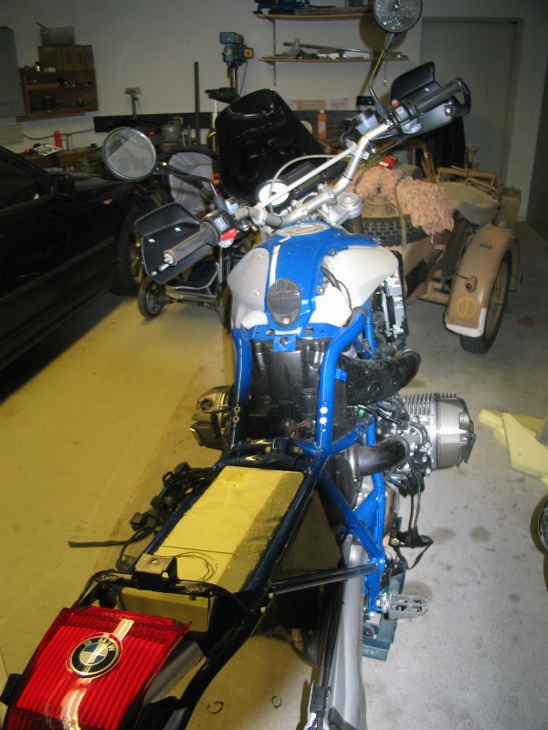

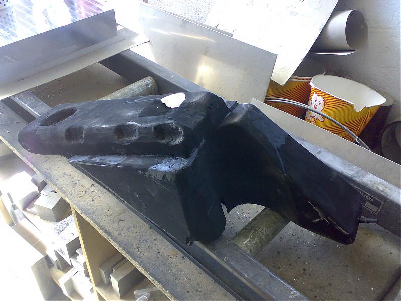

Sofar I have only those two pics, the first one is the rough layout, the second one the form that the tank will have, using all nooks and crannies under the seat. The maker told me it would use the footpegs as additional fastening points. But as I don't have passenger footpegs, he promised to design it in a way that I can mount it too. He intends to have the filler cap under the seat as he is using the quick release for the seat from TT. But will make some with filler cap on the right side. And it will work with an 18" wheel. I'll keep you posted.
http://www.gs-forum.eu/attachment.ph...3&d=1207071132
http://www.gs-forum.eu/attachment.ph...7&d=1207828755
thank you, is very good it uses rear pegs mounts, and that allows space enough for rear wheel travel. I see your friend has a sidecar WWII BMW on the garage, good.........those guys are very clean and practical on its adaptations of new accessories and mods.
Please keep us updated about the final prototype installed, pump, etc...
