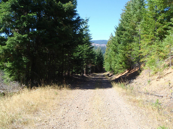

What a relief
when we connected with this super-highway:
If it stays like this, maybe we have a shot at making the coast by nightfall.
but even here, it was hard to get our speed up. In the vid, I try to explain why... "taking a turn 'a little wide', turns into 'a lot wide' when you start sliding down the cliff."

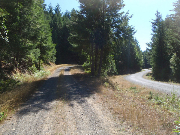

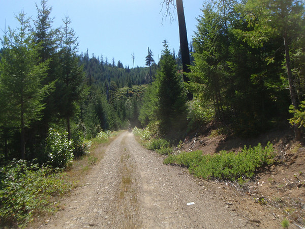

Just past here
the road started to open up some,
and I remember thinking to myself,
"if it stays like this...
maybe... just maybe
if we push... we'll make it to the beach!

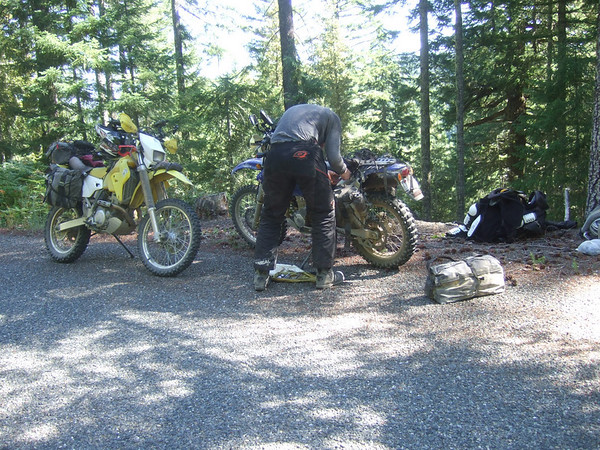

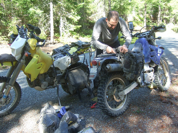

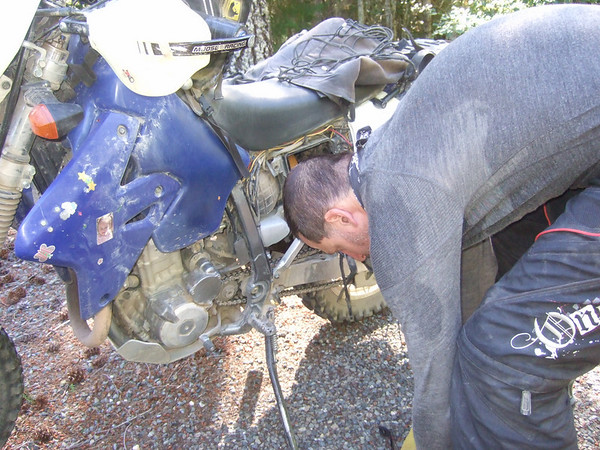

we bounced on to a short paved connecting road. The dirt road we wanted forked off to the right. Francine missed it, and stayed on the pavement.
I yelled over the Scala... "you missed the turn"....
"Fine, wait for me while I turn around".
I waited.
"Hey," I hear over the intercom. "my bike stalled while I was turning around and it won't start back up... it sounds like the battery is dead."
Grrrr....then hmmmm.... then...
"we don't have time for this", I'm thinking. Maybe the revs weren't high enough in the technical riding we've been doing today to keep the battery charged???"
As quickly as possible, I pull out my multimeter, the jumper cables, get the side panels off both bikes, which necessitates unstrapping the bags...
grrrr....
and still, the bike's not charging. I can get it jumped from my bike, but it's only putting out 11.36v at 5-6000 rev's.
It starts to look like we won't make it to the coast today... and maybe even never. We're 60 miles from Port Orford. LDF is having a hard time wrapping her head around it all. You can see the disappointment in her expression as I explain the troubleshooting and diagnostics I've done up to that point:

I think I know what your problem is, Check the alternator/rectifier wire coupling. Had the same thing happen to me.
They have a nasty habit to melting, and then they ground out. It’s an easy remedy; just get rid of the coupling, and hard wire them.
If you have any questions, please feel free to PM me.

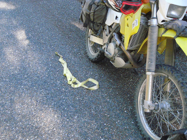

So after checking the maps, my first idea was that since we had access to pavement, to get the bags back on with the side panel off, jump start blueberry, and ride back to Glendale which was close enough to the I-5 corridor to have cell service.
We didn't want to carry on forward, 'cause we weren't sure how much technical riding we'd be doing. If this had happened just 40 minutes earlier on that nasty trail, we'd really have been stuck. I was applying a "damage control" strategy where the primary directive is to stop further harm to the ship, and the secondary directive is to seek safe harbor where thorough repairs can be performed.
So that's what I did... only Blueberry would have none of it. Her condition deteriorated rapidly, first just a few backfires, then idling only and dieing if the throttle was cracked, then she wouldn't even start, and I was risking killing my battery as well.
So now she's dead in the water. It's about 4:30pm, we've been at this for about 2 hours, and the shadows are starting to get long. It's about 25 miles to Glendale, so we load the bikes back up, and I break out the tow strap.
Mr. Happy Puppet tried his best to boost morale, but things were looking grim.
I'd only towed once before, but knew that the opposite footpeg-footpeg technique was the safest way.
I briefed LDF to be attentive to the slack, and off we went.

we picked up a bigger road. In the silent periods between when we were yelling at each other about the slack, I was racking my brain, going through the various components of the charging system to try to figure out what went wrong that would explain the bike's behavior and failure.
as you can hear, I had narrowed it down to CDI or stator.
