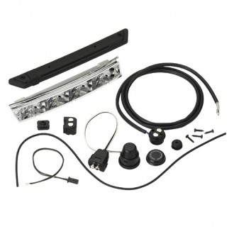

Pictures of Yamaha/Givi Topcase additional light install.
I recently fitted the Givi E94 additional rear brake light to the Yamaha / Givi topcase with the aluminium Yamaha rear rack.
So if you have this rear rack....
And one of these topcases....
You can install one of these....
Make sure you use the black replacement part in the kit otherwise the light will not sit well in the topcase. This is my attempt at using the parts with the Yamaha rear rack. This does mean some of the parts are not used in the kit and you will need to cut the power cable.
This is looking into the topcase from the side.... A small hole drilled into the "pushout" part of the topcase with a rubber grommet to keep it water tight.
This is looking up underneath the rear carrier, note the marine waterproof connector that will enable you to disconect and remove the topcase. No holes drilled and cable held in place with 3M sticky things and small zip ties.
If you follow the underneath of the rear carrier the cable can drop into the under seat area like so. See cable on left....
Another shot....
And another showing where the cable drops under the frame to access the rear light wiring loom...
This is the waterproof marine connector I used in kit form. You just crimp the wires and put it together....
And thanks to bigwhheelsturning for the "how to" on accessing the rear loom to connect up found here...
http://www.youtube.com/bigwheelsturn.../4/oKw3IQ1PS_8
Hope this helps out...
Jon
