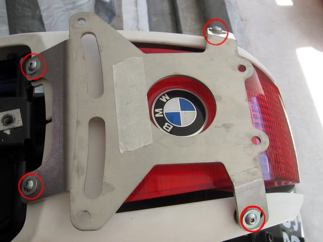

Originally Posted by cyclop
I have just added the provision to mount the ADV top box using the bracket (P/N : 71607696292) from the 800GS and lower part of the Touratech rack.
Touratech rack and with top plate removed:
800GS bracket mated to the Touratech bracket. Need to drill a couple of holes for the M8 bolts (supplied with the GS bracket) and the bolts need to be shortened.
Done :
Added some cushion (tap rubber washer sandwiched between 2 metal washers) between the GS and Touratech brackets at the 4 bolting points:
Cyclop,
How sturdy is this setup? Can the rack be used as a passenger grab rail when the bag is off, or how about a back rest when its on?

The Touratech bottom plate is mounted to the rear subframe at 4 points. The box feels planted.
Have not tried leaning on it as I only ride one-up. As a grab rail, I do not think that it will be comfortable as it is narrow, hence requiring the passenger to reach back and squeeze his/her arms close.
