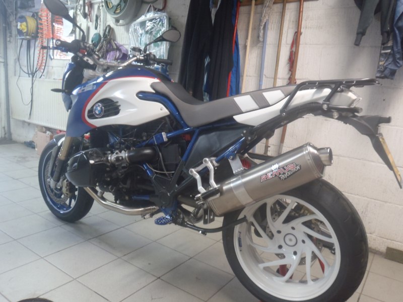

Old 05-14-2012, 08:47 AM   #2217
GSMarc
GSMarc's Avatar
Joined: Dec 2004
Oddometer: 723
Hi Tony,
I had first AROS because it fits perfectly on the original Akra.
Remus will not and you will be obliged to change the can too with it.
I have changed the header and can with full Remus now because I found the Akra too "big", too thick.
Did that on the 2 HP2
I'm sure Dynojet will also work perfectly if your local shop is a pro.
