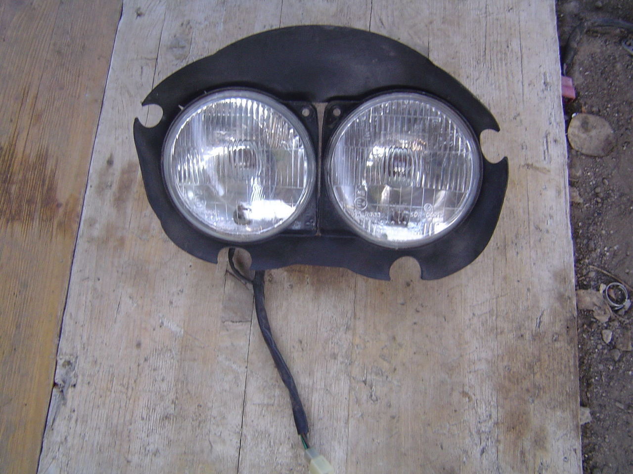

Cory, I saw your question about the output shaft on my flea market listing, I don't want to separate the gear cluster assembly.
You are correct, it would be a huge job to replace just the output shaft and unless you did it yourself it would simply be cost prohibative. It took many hours just to get to this point of a disassembly.
