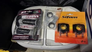

Greeting from the politically correct capital of the world....KALEEFORNEEA
Wishing you all a gratifying non-religious, non-denominational, winter solstice holiday.
....and a Happy Christmas
PRESSIES !!

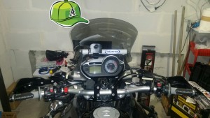

Not mine but I saw it at the beach this afternoon.
