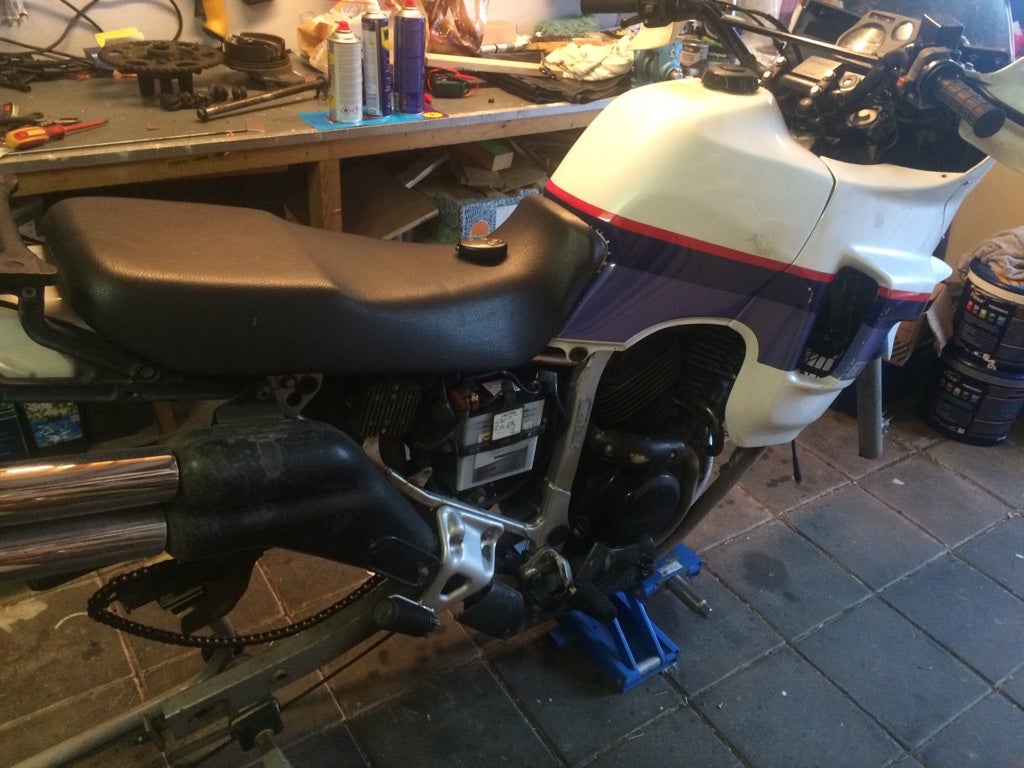

Update on my build...
Well, the build has gathered some steam in the last few days and I am surprised by how much I have gotten done. Well, it was time to dig into the last two major issues left on the mechanical side of things: Carbs and valve adjustment. I truly can see why everyone talks about the tight fit on the valve covers, if you don't have the carbs pulled and hoses removed they are not going anywhere. Well, since the bike is stripped it was not a big deal. Out of all six valves only one needed to be adjusted and that was only a minimal adjustment.
There was one significant issue in trying to do the valves, the center plug on the stator cover has seized itself into the housing to the point, that when I was trying to turn it with an allen wrench, a section of the plug fractured off in a metal chip. Nothing that made it fail, just a chip from the surface...so at some point I will be ordering a new one to replace this. Aluminum is so easy to gall in place its not surprising.
Note to anyone looking to replace the spark plugs! Those dang things require an 18mm socket to pull them out!!! I was going nuts as I have every spark plug socket known to man and nothing was fitting, so off to the auto store to look at tools. The manager said, Oh Yeah...you have one of those plugs they made for a short time that takes an odd size socket which we have! $5.00 later I was at home only to find out that while you can loosen the plug, the dang socket was stuck in the engine head. It required that I had to grind the edge of the socket down to a rounded smooth surface and it slipped in and out like butter. Anyway, any reason to buy a new tool.
But with the cover off I was able to inspect all the gears and stator, surprisingly there is no sign of wear on the gears and everything was extremely clean. I have been slowly discovering just how clean this bike is...luck of the draw on my part.
Now with the valves done, it was time to dig into the carbs. I spent the better part of an evening detailing and cleaning the carbs down to make them look like new. When I opened them up the diaphragms had no holes and were surprisingly clean, the rubber was very supple and I think they had about another season in them so it was a good time to replace them. I also did the slow jet 40 mod and that was a breeze. With this done I shut down for the night. I have found that taking small bites of this elephant each day allows me to focus on single tasks rather than trying to get lost in details and miss something.
Now, for anyone who thinks that mounting these carbs back on the engine is easy...well, that quite far from the case. You need to one, make sure they are oriented such that the notch on the rubber sleeve is aligned with the mating surface on the engine. Next, put some lub on the rubber sleeve on both ends as you need this to allow the carbs to slip into place. Trust me, trying it without it will leave you very frustrated. This is one area I would like to smack the back of the head of the engineer who designed this feature. Ugh... The same thing with the first part of the airbox that mounts to the carbs. Those fittings need a little lube to ease the mounting. I found that using a soft rubber weighted mallet was able to give the nudge and seat properly.
OK, now I need to address an issue that come up with regards to the 250 shock mod and the orientation of the reservoir and whether or not it will fit with the air box. I can say that it fits with NO MOD to the air box. It clears with over a 1/2" of clearance and there is no issue with the shock moving and hitting anything. So, it is possible to go with the orientation I have gone with, not loose the overflow bottle and have the banjo facing towards the wheel verses facing the engine.
A few other things, but I will save that for another post and some pictures.
