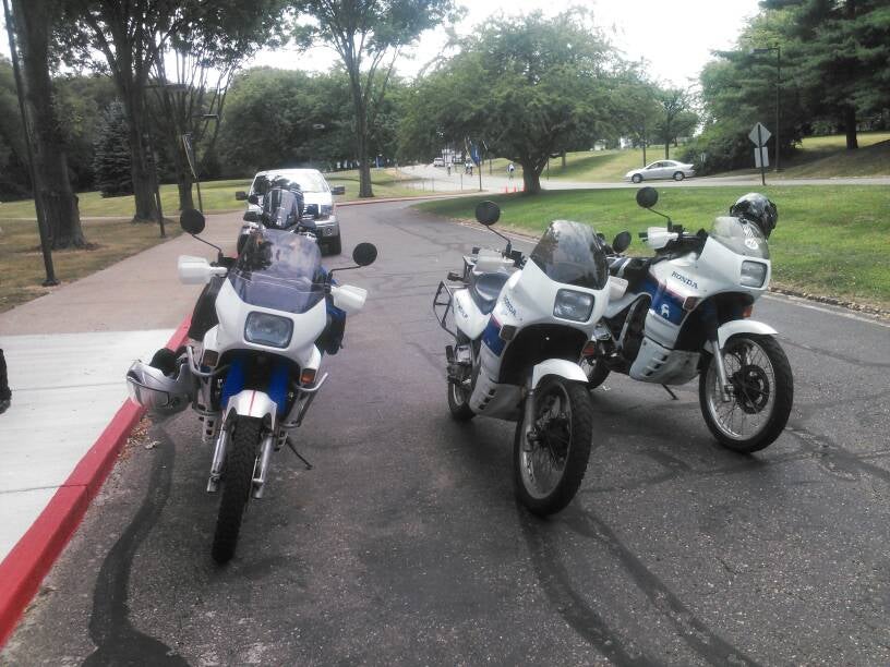

Thanks for looking, but I found a dealer in Cincinnati that had 3 bolts in stock, so I had them ship all 3. Just buttoned up the TransAlp earlier today with the new bolt and new crushrings; no oil leaks.
My UPS driver should be dropping off a new HyperPro rear shock and Ricor Intiminators along with some other bits and pieces for my other bikes tomorrow, so it should be another productive day in the garage.
