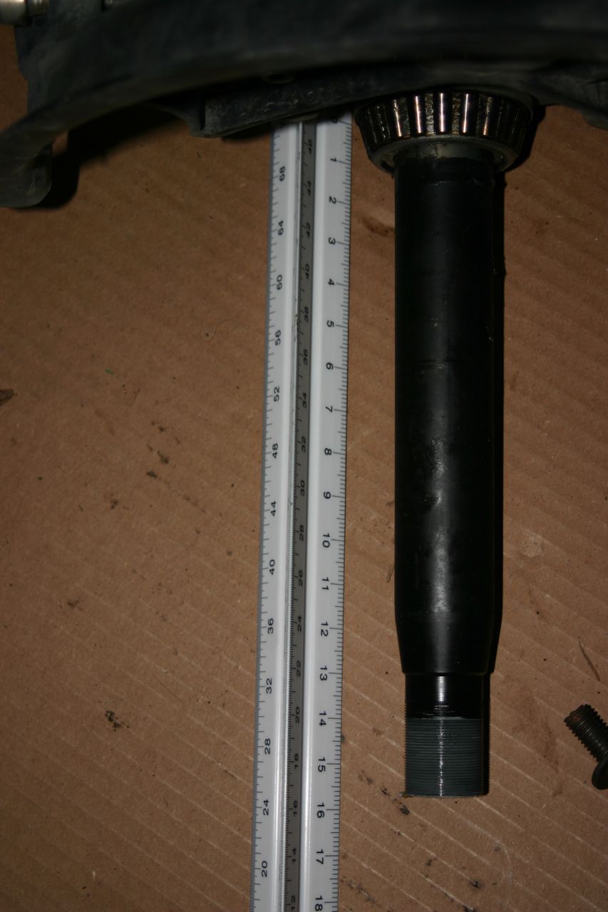

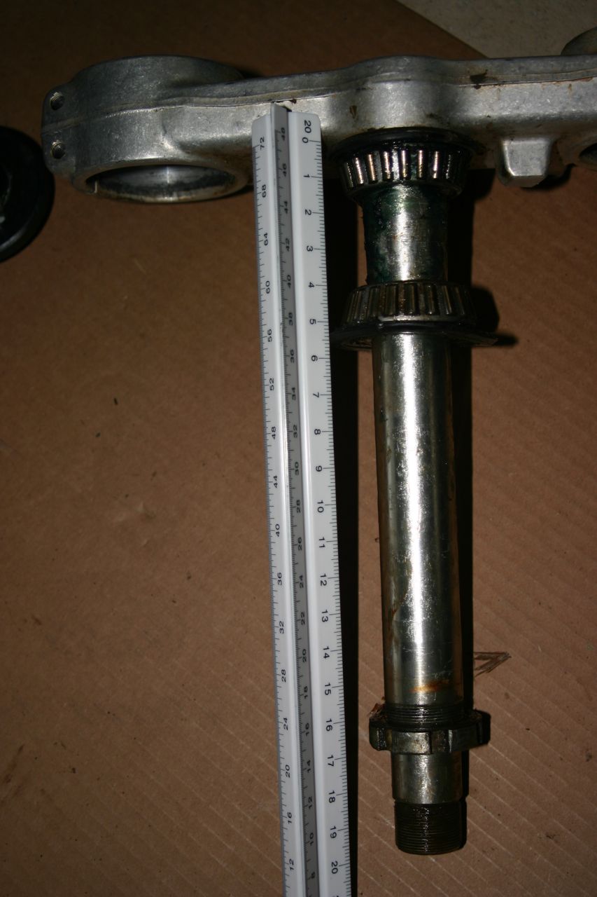

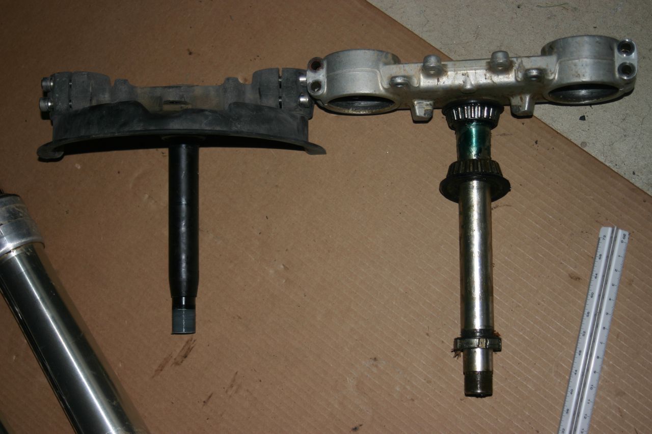

on a separate note, i have 2 small issues with my Yamaha forks that i need help with.
1. the headstem. the Yamaha bearings fit the BMW races, however, the headstem seems too long! when i install the assembly and tighten the headstem nut, i run out of threads on the headstem before everything is squished together. measuring the headstems, the BMW is about 14cm from base to where the threads start, while the Yamaha has about 15.5cm before the threads start.
2. bar clamps. did you guys that did this also upgrade to fat bars, or are you using the stockers? because the bar clamps on the Yamaha triple clamp are huge!
My understanding is that you just need to put a shim between the nut and the bearing, something to take up that space.
As for the bars, I'm wondering if this project wouldn't be the perfect excuse to go to fat bars anyway.

thanks jdluke. a shim would make sense ... i'm surprised it's the first time i hear of this though, as everyone always says they fit right up! well, they almost fit i was actually thinking of having the headstem threads extended a further 1cm.
as for the bars, yeah, i guess i could go with something more stout, but i didn't want to lose my heated grips!!! hehehe.
