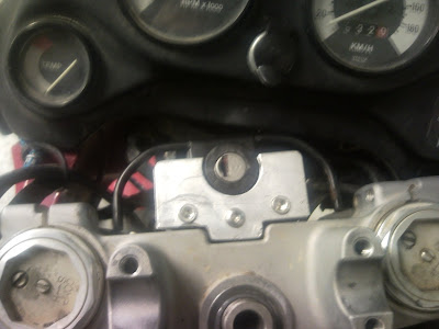

Just put the ignition bracket on it and can't help but think how it's a fair amount of weight for a little 5mm bolt. Has anyone done it a bit differently?

My ignition bracket is held by a 6mm bolt and it sits on a ledge appr. 25x10mm
I thought the same but there's really no where else to mount it off, i'm going to look at it again when i take the forks apart to revalve them.

nice set up. have plastic one made up but need do something same as yours to make it more sturdy
what about the toutatech set up for the ignition lock? be nice way to go
Nice, I made mine of 80x10mm aluminum, I sank it over the numberplate fastener to seat it perfectly on the "ledge"

Originally Posted by BMW Iceland
Nice, I made mine of 80x10mm aluminum, I sank it over the numberplate fastener to seat it perfectly on the "leadge"
yours looks well. i located mine in same spot but i want to secure it a bit more to the forks so the steering lock will be more secure

Same. Reckon the momentary forces are really too much for the lock to be of any use. I'm thinking maybe welding a bracket to the clamp top and bottom. It's a shame the unit is steel.
What about using an ignition from another bike. I know the DRZ is light, but hasn't got the dust slide. And than you're stuck with 2 different keys. Dunno if you can re-key those things.
How do those TT ones mount, and where did you find them?
I'm not fussed about the lock as much as I'd like it to stay on. Think 10000km of African corrugated roads.

TT are very particular on selling spares only to those who have purchased the full kit, one or two have commented on it elsewhere
Interesting on the TT setup that they dont use 1 way bolts so the assembly looks like you could unbolt it anyway. I noticed their Yoke uses 8mm bolts to attach the bracket
A piece of U Channel may be more robust for the mount, that is the direction I will be heading. With a little enginuity the bolts should be able to be hidden & unable to be accessed to unscrew the assembly

What are you thinking to bolt it to though? The same 5mm hole?
The whole thing including spacers and bracket (all alloy though) came in at 405 grams. So with the plastic ignition switch barrel it'll probably be a good half kilo. Fair bit of weight.

I am going down the KTM path & the SX Yoke has 3 x 6mm holes to mount to on the forward face of the yoke
The U Chn I will use is 40x50x6mm which I have from another project
The height of 40mm is just right for the lock height & means the lock can be supported at the top & bottom & the bolts attaching the lock to the bracket will be on the lower side of the U channel
Looking at the Yamaha yoke I would be tempted to tap 2 6mm holes into the forward face & put clips on the bolts under the yoke for security
Drilling & tapping the yoke may be frowned on but that is what KTM have done with their yoke

I was thinking along the same lines. Would look better than welding as well.

i'm having trouble getting the locking bolt for the steering lock close enough to engage worth a crap (I'm on the WP/ KTM set-up). A healthy dremel session will be in order to get it to work.
If you fill in your allen heads with JB weld or even bondo, it makes them quite difficult to spin free while in the field, yet a few minutes with the proper punches will clean them out in the shop, if you need to adjust or service the unit. Not a perfect solution, but it is a deterent to would-be-thieves.
