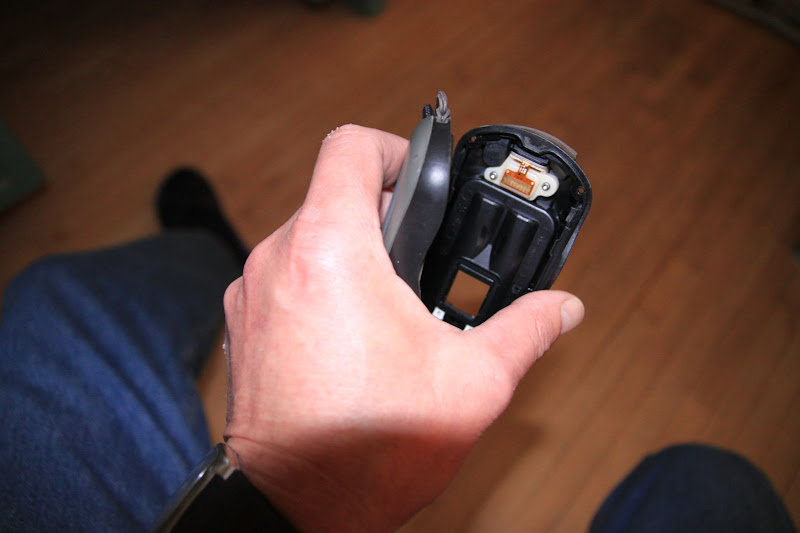

Oddometer: 411
Originally Posted by Emmbeedee View Post
So, it is a screw-in connector with surface connections to the main board. Should be a cinch to replace.
I wonder if we can get Garmin to replace only that for a nominal fee? Will phone them today and ask.
any idea where we might be able to purchase the screw in connector? ive got connection issues but would love to be ale to fit it this easily. are the screws under the battery cover a standard allen key head?
No idea where to get that part on its own. To get it from Garmin would cost $100, the price of a refurbished Oregon, in exchange for yours... And the screws are likely Torx, the same as what holds the Oregon together...
Why look for another damn miniUSB connector? Can anyone find or make a surface mount connector for the new cradle connector as used on the Montana, or the old 4-pin round connector as on the 60 series? If someone would make some of those, I think it would save a lot of otherwise nice Oregons from the junk drawer. Maybe RAM could make a cradle for Oregon+Montana connector.
unfortunately this is australia and it will cost me $262.30 (to replace a $10 part!) after speaking to them on the phone. i could sell this one for $100 and spend an extra $100 on top of the replacement price to get a new one with a warranty.
