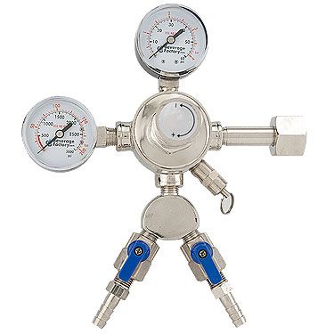

I keep mine at 10-12 psi also and get perfect flow through about 5+ foot lines, so it definitely needs to be below 18.
I just upgraded recently to a new kegerator and regulator, and now have this one:
working well so far, and I like seeing how much is left in the co2 tank.
by the way, if you're dealing with o'shea's, I would look elsewhere for co2 refills. they keep it warm, and it doesn't seem to fill all the way. I was constantly refilling, and verified no leaks. after a refill at a welding gas supply, where they fill it at a freezing temp, it lasted much longer.
I'm also trying the while polypropylene lines in my new kegerator (ice maker lines). tough to get on the fitting, but seems to work well and no taste issues. anyone else try these?

Man that is purddy I like the easy dial pressure adjuster.I have to use a screwdriver.
