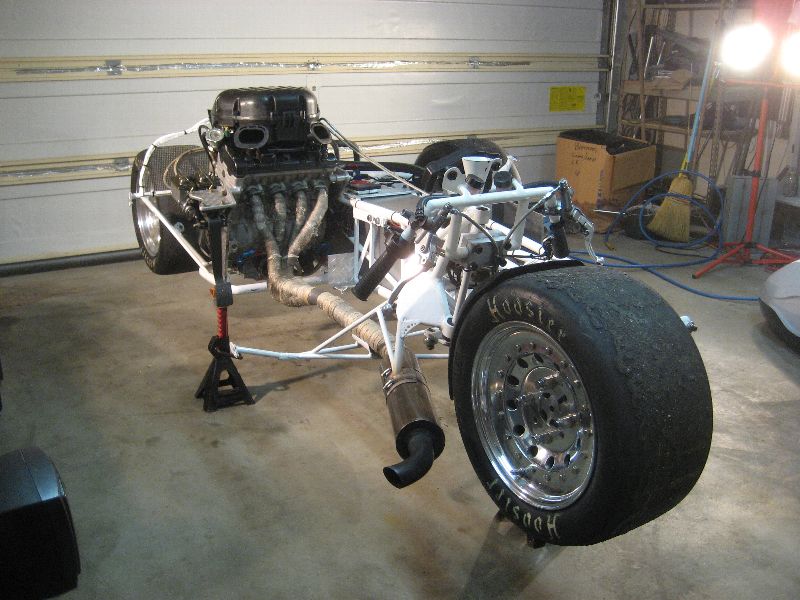

I've never used jacks to get a bike with a sidecar up in the air, I've always used leverage and planning.
All it takes is three standard jack stands and two people. One once you've done it a few times and figured out the best order to do things in.
One... Lift the chair wheel so the sidecar is up on the balance point.
Two... place your first jack stand somewhere solid between the rear wheel and the chair, as high up as it will go, biased more towards the rear wheel.
Three... push the chair wheel back down to earth using the pivot point of the jack stand to lift the rear of the bike off the ground... generally a good distance.
Four... place a jack stand on the outside at a fixed point behind the engine. I generally use the frame or forward portion of the swing arm cross member.
Five... Lift the chair wheel up (pretty easy) so it's level with the rear wheel.
Six... place a jack stand under the sidecar frame biased behind the chair wheel axle, on the outside frame loop.
Seven... Go to the front of the bike and lift it up (easier than you think if you got your rear jacks forward enough) so it is level.
Eight... slide your third and final jack stand under the front of the bike along a frame rail or suitable hard point with a bias towards the inside between the chair and the bike.
That's it really, no jack required. I've used this method of Chinese-hack-lifting to lift all my bikes once I figured it out for myself one day. I cover the tops of my dedicated jack stands (set of 4) with soft leather to keep from marring the paint on my frame or the aluminum bits.
I get this up in the air 20 inches by myself using this method. Same with our heavier-by-150-pounds CSR, the RGM, and other standard motorcycle/sidecar combinations.

Originally Posted by HogWild
In the garage it's not an issue for me. Out on the trail it's a whole different story. For me the main need for a jack out on the trail is to be able to pull a wheel off to fix a flat. The side wheel is easy. Just lift the sidecar until the left foot peg hits the ground. For the front and rear you need something to help lift, then hold the wheel off the ground. I do both with a single 1 inch square aluminum tube about 18 inches long (light weight, easy to carry).
That's an excellent idea. And works along the same lines as my fulcrum/leverage concept to get a rig up in the air without a jack.
I bet with the addition of a single custom lightweight collapsible jack stand this would make an excellent trail kit for any standard sidecar.

Maybe I'm just freakishly unusually strong, (which I doubt) but I have yet to come across a rig that I couldn't lift the chair wheel up on by putting my back to the chair wheel, grabbing the tire/frame, and just lifting with my legs.
It's the same technique they teach Gold Wing riders to right their monsters when they fall over. I've seen little ladies do it at motorcycle shows.
Once the hack reaches a height of more than a few inches it gets progressively easier to lift as the motorcycle turns into a counterweight to assist your lifting effort. It's all technique.
I've used the fulcrum technique on several different configurations of standard road sidecars, race rigs, three wheeled devices... to get them up in the air.
Hell, out on the road with the RGM when I had to fix something I used a technique just like what HogWild described but substitute '18 inch square aluminum tube' with ' strategically placed full face helmet' to get the job done.
