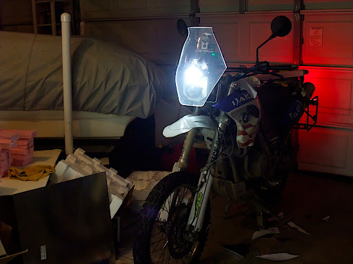

All paint. Rattle can. I had to paint around the headlight because as another FF pointed out it reflected back on me. That's also why I made the thin aluminum light shroud.
Thanks, Wow, That's a great paint job.
I'm too fucking lazy, so I might just use those cheesy carbon fiber stickers and be done with it.
Did you have to paint both sides? I'm having problem with the ligth glowing all over the clear shield. The throw of the beam is fine, but the glow is distraction/dangerous I'm not sure painting around it would help.
Actually I made sure to paint the edges. I used to have a big windshield before dropping the bike... and the edges glowed and drove me crazy at night.
So make sure you either tape them or paint. I used semi gloss enamel on the front and flat on the back side. It's actually pretty easy if you just do really light coats, but to each his own.
By the way, your bike is going to be very cool too.
