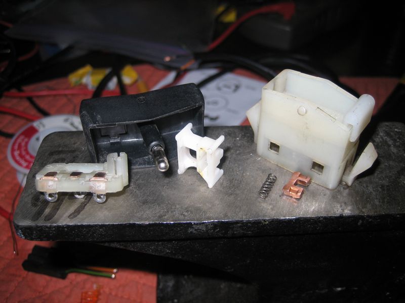

ABS Switch problems
Hello all,
Love my '07, lots of fun, however will be on my THIRD ABS switch when #3 arrives from Germany (warranty)...anyone else had problems not being able to turn the ABS off when hittin' the dirt?
I'm not that good a rider so need all the help possible....ABS on dirt can be scary (if you ride fast....and aren't very good)

ABS switch
Originally Posted by yatman
Hello all,
The switch on my 03 Dakar has always been finicky and sometimes requires me to hold it down for several seconds before it engages. Also, sometimes it seems not to want to turn off the ABS unless I rock the bike forward and backwards an inch or two.

Yeah. They're pretty shit.
Borrowed this picture.....
Exposed solder connections and everything. Try spraying some electrical cleaner into them. Should do it. All it does is close the circuit for a few seconds telling the ECU to turn it off. Any switch that does that will work. Or you can short it.
