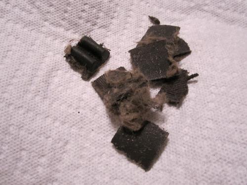

Those are the bits that I fished out of the variator housing vents on the side of the road.
I'll pull it off the trailer and open it up to see what else I can find. I probably need to replace the roller weights while I'm in there.

Shredded a belt on my 50 on the way to take a test in college. That sucked. Destroyed the replacement shortly thereafter - make sure both sides of your variator are SMOOTH! The slightest divet can lead to premature wear.

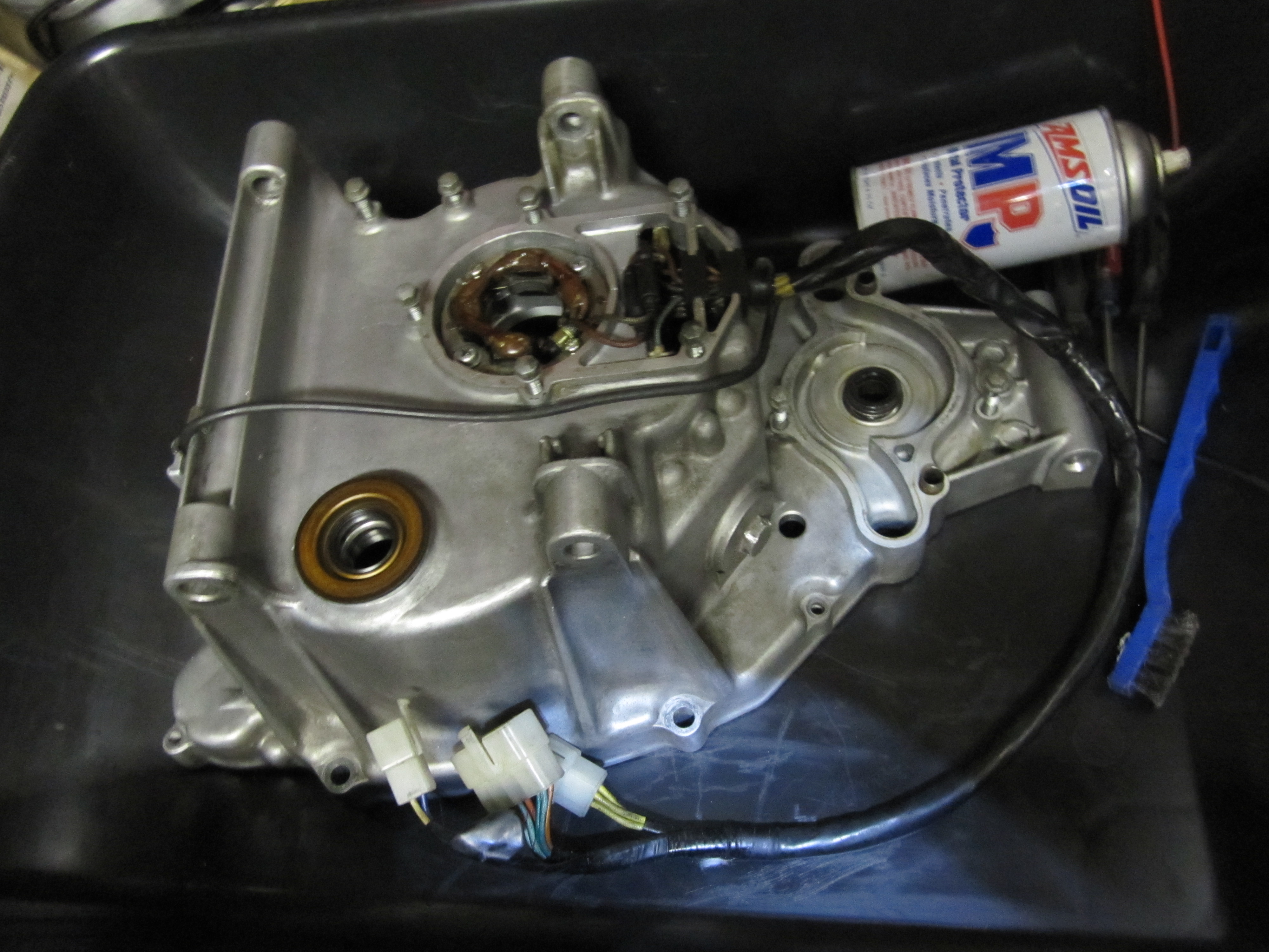

CX500 is down with a bad stator. I need to drop the engine and swap the rear case for one with a working stator.

Ouch. I'll be sure to inspect all the surfaces.
I suspect that this is just a case of the original belt reaching its end of life.

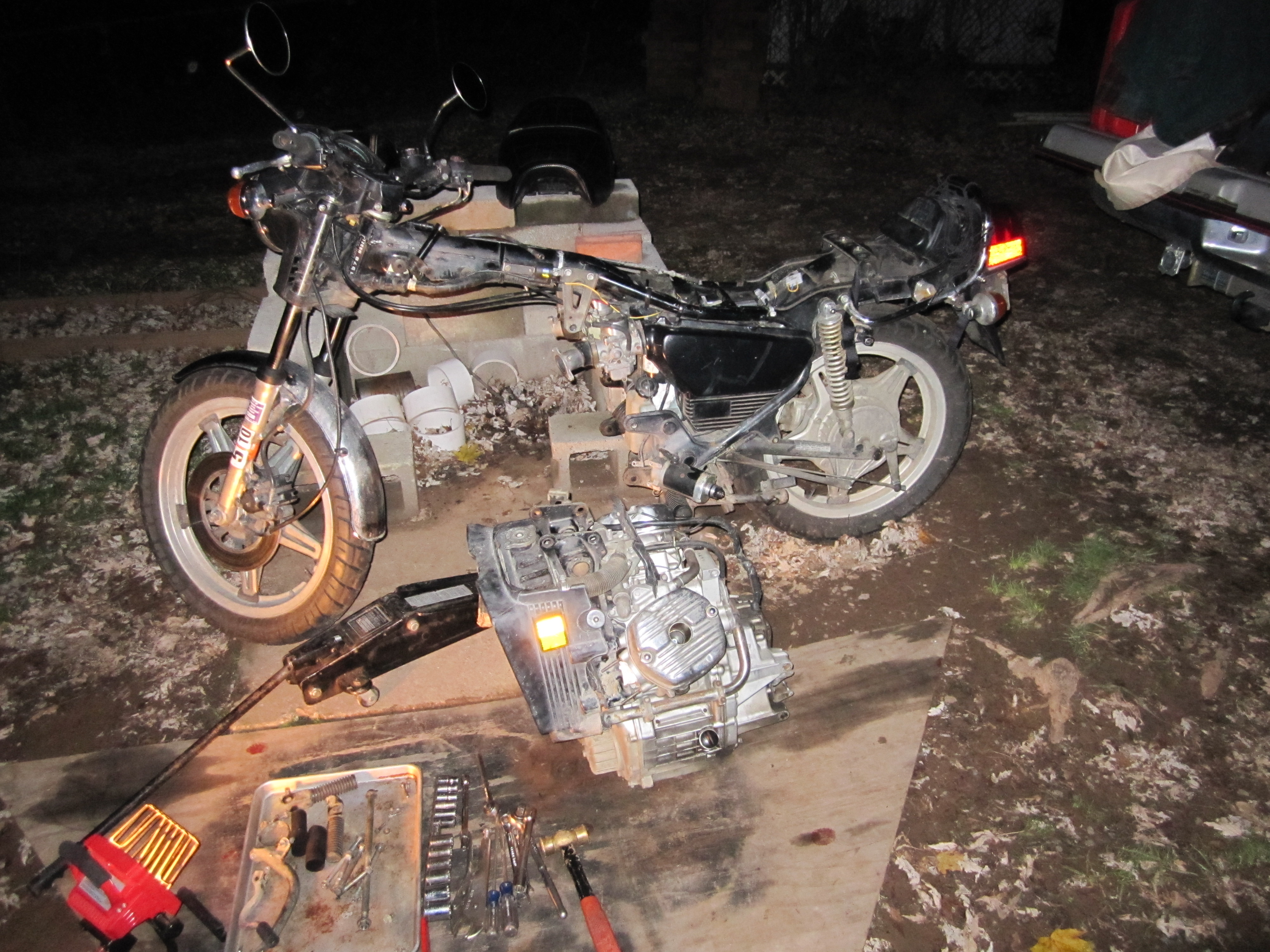

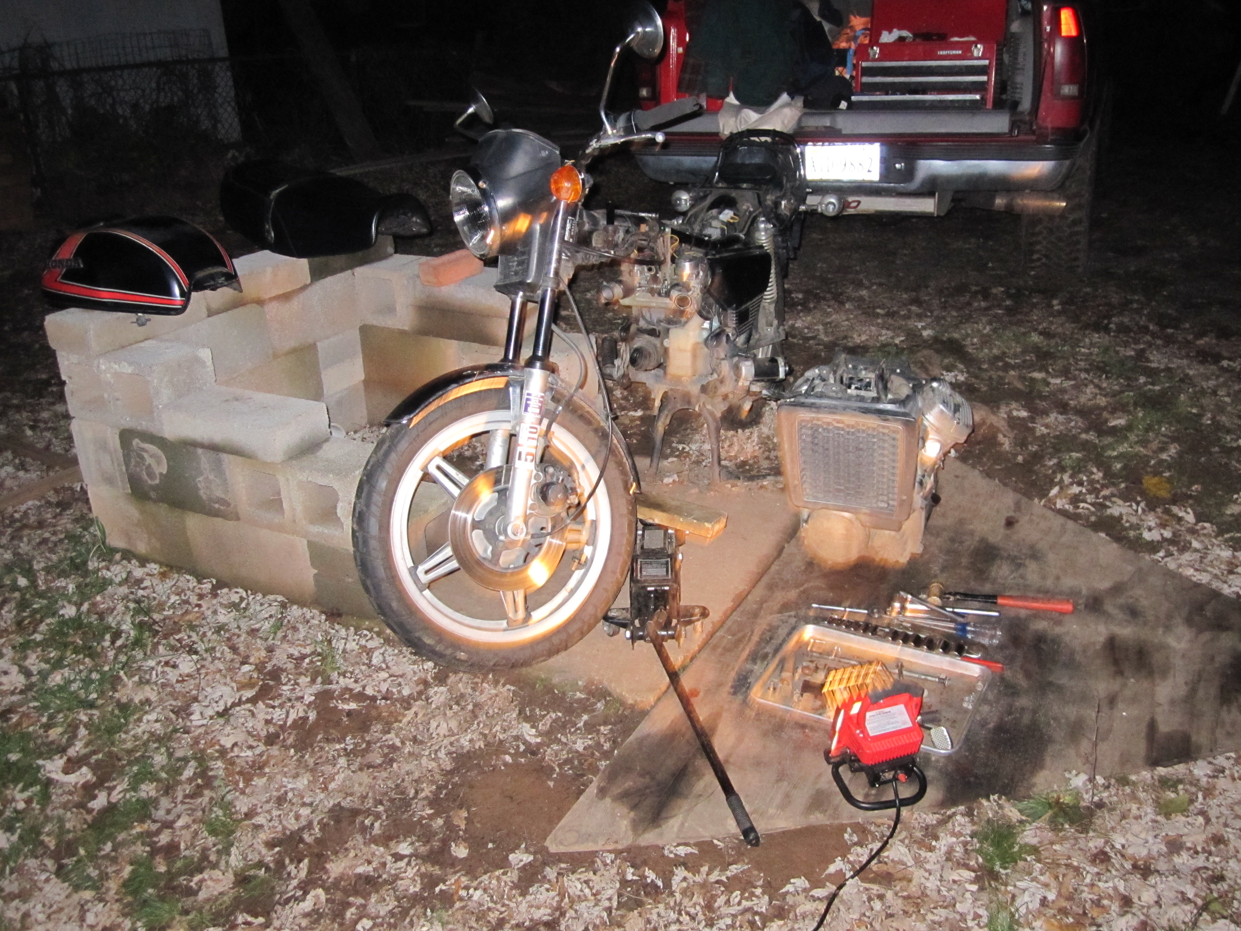

Since the replacement belt for the scooter is a few days (weeks?) out I thought I'd see about tackling my stator swap.
It takes me ~20 minutes to drop the engine, and I figured another 15-30 to swap the rear cover and 20 more minutes to re-hang the engine. I was hopeful I'd be about done when my wife came back and be able to go for a night time test drive/grab.
I ended up spending 45 minutes fighting with the exhaust system before I found the right contortions that allowed it to be removed.
Once the exhaust was removed the engine came out without any trouble.

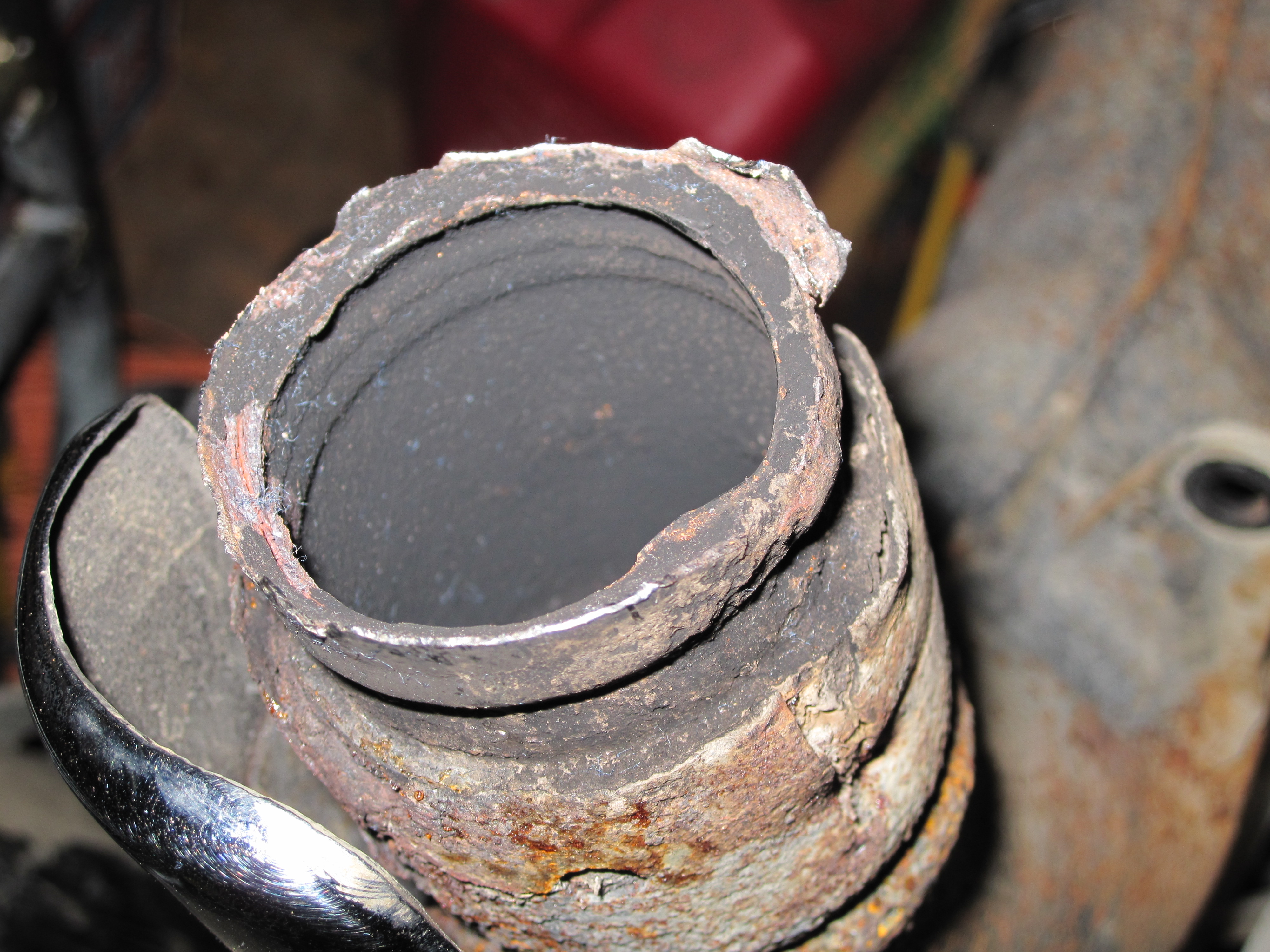

I'll tackle the remaining work tomorrow. I need to come up with some exhaust tube to repair my left side muffler.
Scene of the battle.
Busted muffler pipe. / Replacement rear cover.
