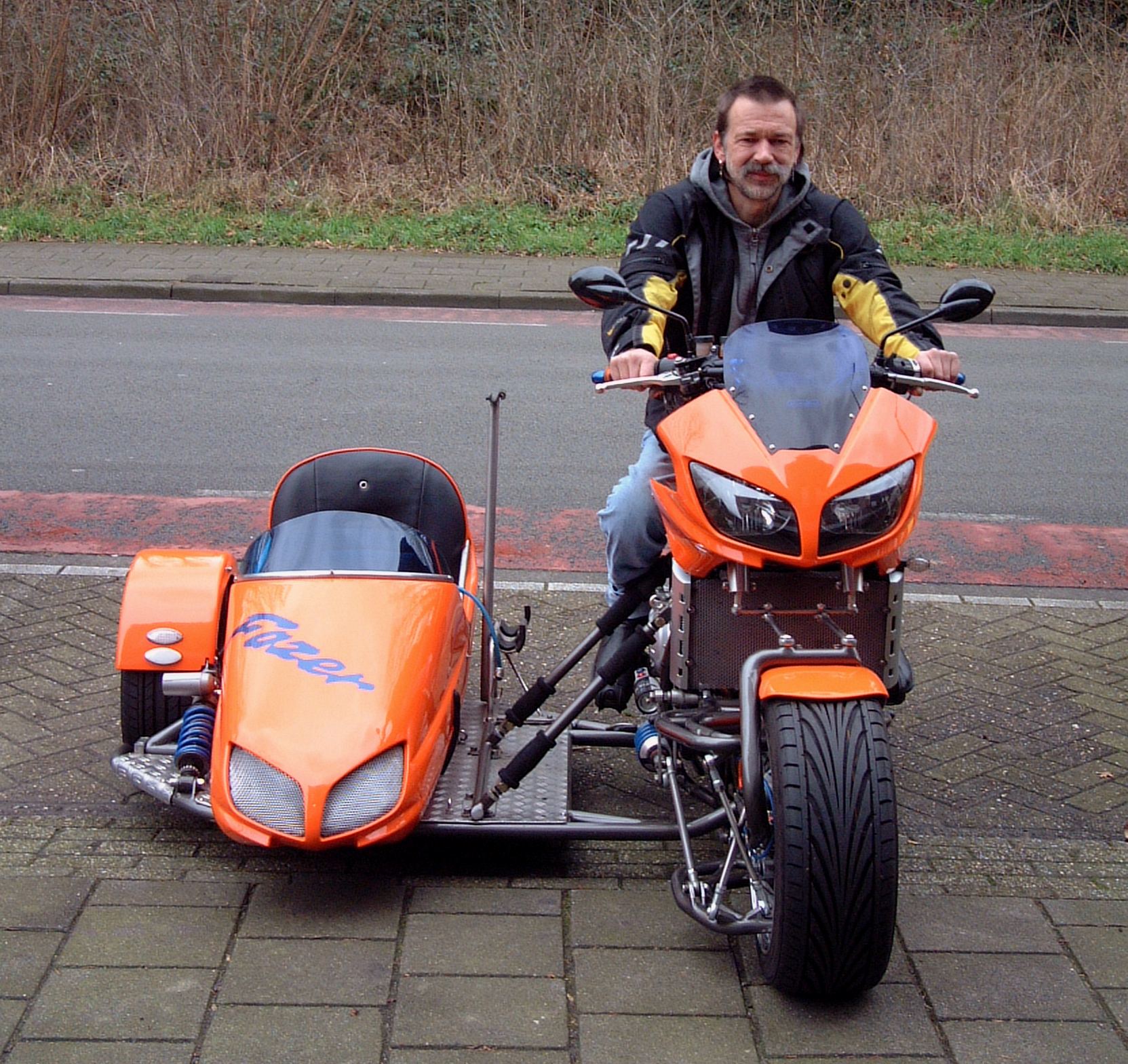

yes they are! Richard
only Roland his was a real leaner! Eugen has been testing it (schurfing... )
but with his handicap Roland wasn't able to hold the bike, he made an electrical-hydro system, but he didn't thought about the weight of the bike wenn its leaning to the left......afterwards he changed everything, even made an complete new combination from his leaner. see picture orange hack above!
he got the best price for complete sidecarbuilding at the EGT in 2007!
the Flexit is build on an other hack, nice!

my take on the question was that the design should be basically usable for both. If one is willing to do basically a rebuild e.g. like the above Flexit with a totally new sidecar frame and is still happy to live with some drawbacks of the design (e.g. in case of the converted Flexit this would be high centre of gravity with still low ground clearance) it is possible.
Steve mentioned also the issue with the steering, which need to be different for a rigid outfit, which I believe has been the reason for Roland to change the front end on his Fazer when he (or rather his family decided ;-) ) that it should be a rigid outfit and not a leaner.
