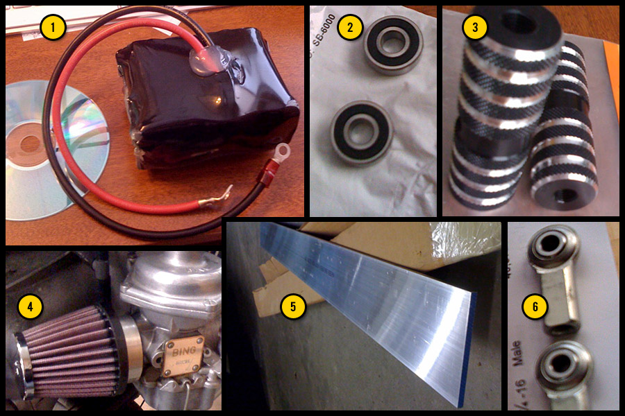

supplies!
Thanks all. Gonna try to keep this project rolling and ready for spring so we'll see how it'll turn out soon enough!
I ordered a few supplies recently:
1. E-batt (now defunct biz) - 300 amp, 30 oz. Lithium battery...hoping this works well
2. Bearings - for shifter arm (more on this later) - ordered at local bicycle shop
3. Free Agent knurled aluminum alloy freestyle bicycle pegs
4. K&N air filters - product # RC-1060 (referenced Shmerel's build thread)
5. Aluminum Flat Bar - 48" x 4" x 1/4" 6061 for shifter and brake arms
6. Heim Joint Rod Ends - (3/16" 10-32) - for shift linkage
I'll post more about adding rearsets next.
