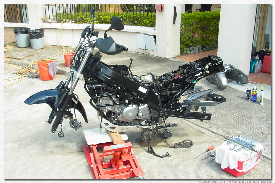

I took my V-Strom apart and kept track of what I used, then browsed the toolkit thread here on ADV. I live in China, and don't have access to mail ordering all the fancy stuff you guys can, so I headed down to the tool market and purchased the best stuff I could find. Most of it is mid-grade quality, but good enough for a portable toolkit.
