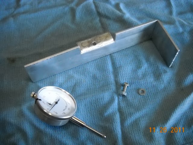

1/4" x 10" x 12" plate glass.
Dial indicator.
Forks aligned. see http://aatherton06.home.insightbb.co...age/TITLE.html
Pictures show the basics, for demonstration only. Notice, gauge is not zeroed. This is only a prototype fork gauge. Stay tuned as it is developed.

You bet I'll stay tuned, I have been waiting for someone to show a proper fork alignment procedure, we were trying on another forum to put that one passed someone who did not want to understand how critical it can be.

The fork alignment thing...been there done that, I just get tired of seeing recommendations on other forums to do it like we used to do on dirt bikes in the old days, doesn't work too well on faster bikes.
Your pics just jogged me up a bit so I did buy some plastics yesterday, gave me a good idea how to mount the deflection gauge on the tire balancing jig so I can check wheel/rotors run out.

Thanks for the info on the brake grease; I've looked at info online so I'll eventually get up to speed. I have the latest version of the dial indicator jig completed.
parts:
back:
front:
in use:
and:

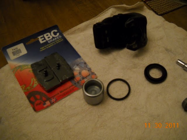

Got new brake pads, pistons, seals, dust covers, o-rings, etc. Brake pads are EBC FA22's from Ted Porter's, http://www.beemershop.com/ . Pistons and seals are a kit for 38 mm ATE, part no. 34-11-2-301-705, from Max BMW, http://www.maxbmwmotorcycles.com/fiche/fiche.aspx .
Seals and pistons go in nicely.
