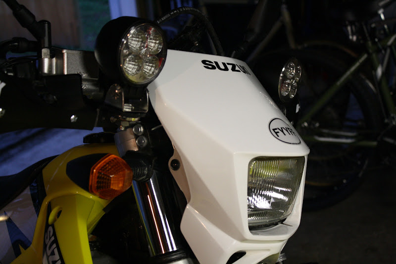

Had them down low, but aluminum bracket was a bit flimsy and the vibrated a bit. Working on a stronger steel bracket, should prove to eliminate vibration at speed.
I have since moved them up higher and they are now mounted to my handguards. Very stable even on the worst of roads.

Do you have an image of the mounting method on the hand guards, can't quite make it out in these images

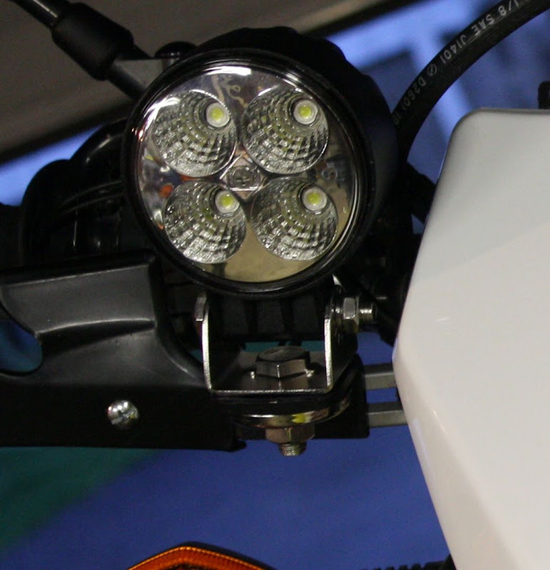

I made small "L" brackets that I mounted to the handguard bar. The lights are mounted to the "L" bracket.
Required drilling 2 small holes in the handguard bar.

Thanks for this
I guess it depends on the bulk of the metal in the handguard bar and the relative size of the holes, don't want to get that wrong and weaken the bar EH!
Great location for them

The bracket is attached using M5 screws (2 each bracket). I drilled and tapped the handguards using the same size holes that the plastic guards screw into. The integrity of the handguard wasnt comprimised. How do I know..... well lets ask the tree that I meet last weekend
