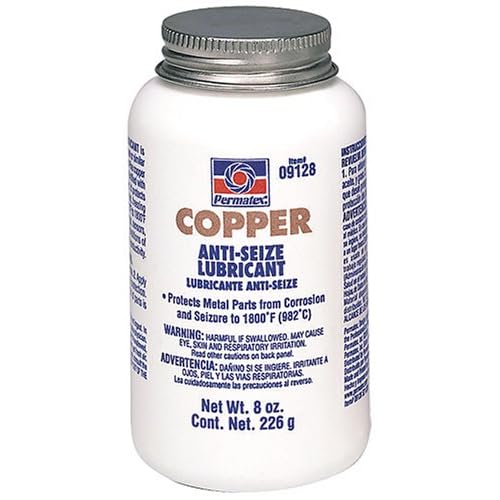

Originally Posted by Beezer View Post
I use RTV for thread locker on frame parts instead of Locktite... on some engine parts too. RTV fills gaps, dampens vibration, and seals out water. It comes off easy when you want & I have never lost a fastener that was installed with it. I use heavy grease on wheel bearings & seals & the axles. Other than that, most shop manuals will tell you what lube to use and where to use it.
You mean this stuff?
There's a lot of RTVs on the shelf. This one is advertised as a sealant and adhesive. Some are advertised as gasket makers meaning they fill gaps I take it.

WOW...... The anti Seize I use is all dry lubricants like graphite. What brand you using?
Contains high percentage of micro-fine copper flakes in a semi-synthetic grease carrier
Fortified with high quality rust and corrosion inhibitors
Temperature range: -30F to 1800F
Provides good electrical conductivity
Suggested Applications; Spark plug threads installed in aluminum, exhaust manifold bolts, engine bolts, oxygen sensors, knock sensors, thermostat housing bolts, fuel filter fittings and battery cable connections
nothing like cut and paste

I use that anti seize on almost everything on my Jeep and a lot of things on my bike. I have never had the grease cook out of it and I use it on my O2 sensors in my jeep... Not many parts can get hotter then the O2 sensor in the header on my Jeep when Im on the nitrous.

I've always been taught to use copper anti-seize on sparkplugs in aluminum heads because of the steel-aluminum interface plus the need for conductivity, but that (and your cut and paste) directly contradicts what Sanchez says about copper not playing nice with aluminum...now it has me wondering.
If you use Copper-Kote gasket cement on an outboard engine in salt water, it'll eat the aluminum and burp out a puff of white aluminum oxide powder faster than you can sneeze.
