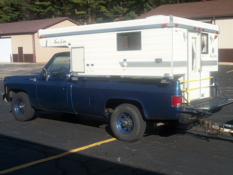

'97 Coachmen Ranger 10.5-footer on a '94 F-350 SRW 4x4. Tork-Lift Tie-Downs, Goodyear G124 13-ply G-rated tires on Vision 19.5" wheels, Extra Overload Spring pack and Rancho adjustable shocks.
