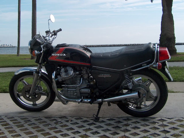

The bike that started it all--1st year 1978 CX500. Mechanical cooling fan driven off the cam, stator-powered ignition.
as purchased:
