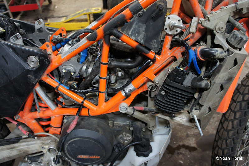

Now on to the bike:
Installed a new Regulator/Rectifier.
New dash.. with Voltage, Temp, hour/tach, 12v outlet (switched with the toggle so I can charge stuff without the bike running)

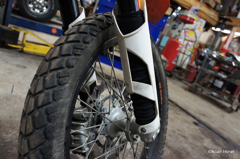

New fork bushings, seals, and long fork gators.
Fuel filter relocated outside of the tank.
Spare sprockets sit on top the RR bash guard. Some modification required.
New softer front springs. I had .58s and we decided to step down to .56s. (stock is .52)
New luggage. The can up front is my spare parts. Spare fuel pump, fuel injector, fuel filter, fork seals, spark plug, ect.

I like the spare sprocket mount... Any chance the bolts could negatively impact the bottom of the engine case?

The bolts for the rear sprocket are set wider then the case. The bolts for the small sprocket are in a "valley" in the bottom of the case. I suppose there is always a chance but i think i'm good... I'll check again when I land on a huge rock.
