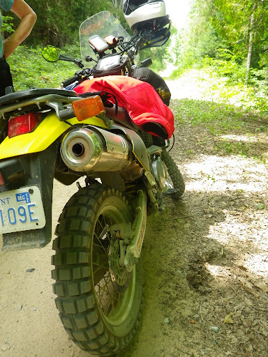

Well, I would think the indicator lens would start to droop a little and it would be noticeable. Interesting, the GSXR can (that I have) must be pretty good at dissipating heat. I've never heard of the grab handles getting hot.
Do you still have the shield on the o.e. muffler? Is it possible the motor is running (really) lean?
This is my wife's bike but mine is virtually the same as this - I have the stock heat shield.
Anyone know if there's anything in the muffler mount which is supposed to stop heat getting into the frame? I'm going to check to see if the muffler mount on my bike might not have all the original parts in it.

I would think that if the grab handle was that hot, the turn signal stalk, lens, rear fender and side panel would all show signs of deformation from heat. Perhaps you're right, heat is transferring thru the mount. I believe both mounts (the one by the muffler and the one where the header attaches to the mid-pipe) are the same; there's a rubber insulator inside of a steel cylinder thru which a bolt passes.
That said, my muffler is directly bolted to the frame. However, both the muffler body as well as the attaching bracket are made of aluminum.
Kind of hard to see but like this:
Image courtesy of KienTech.
I haven't had time to check the muffler mount yet but I'll try tomorrow, and next time I go out I'll use a thermometer to see just how hot it gets. Maybe I'm just paranoid, but I did drop the slide needle down one notch recently.
Well, are there any other signs that the motor is running lean? For instance, white tipped or "melted" spark plug electrodes? Dull red glow on the header pipe?
Why did you lean the carb (by dropping the needle)?
Can anyone else offer any thoughts/ideas?
