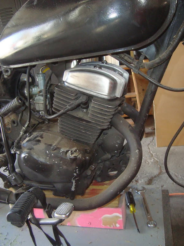

I wanted to check the valves, and while I was at it I stripped the paint off the cam cover and hit it with a nylon wheel on the bench grinder. No before pictures unfortunately, but here's the after:

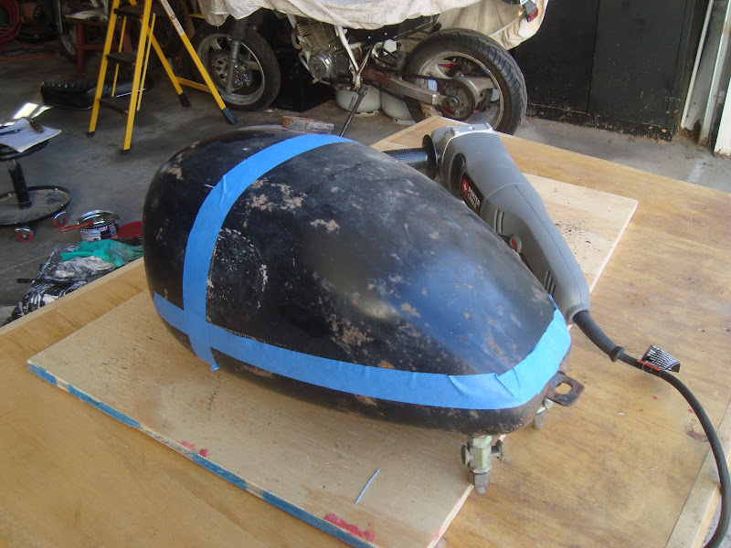

The gas tank is a little screwed up where the stock hinged cover has been ripped off so I was on the hunt for a new one. About that same time my uncle's son is cleaning out some junk and comes up with some unidentified chopper frame with a peanut tank. Score! But once I had the tank in hand I realized the tunnel would be way too narrow for the stamped steel backbone of the CM. So I'm just going to figure out a way to dress up the stock tank, but I had a Plan B for the peanut:
You can see the remnants from the tank's previous tenants. I kept waiting for it to burst into flame as I was cutting.

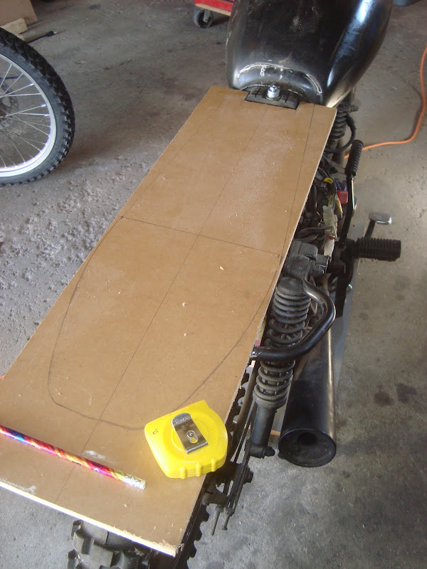

Well I finally made some progress over the past few weeks. First I laid out the seat base on some 1/2" MDO (waterproof plywood).
Cut out, with a couple of t-nuts and the hump roughly in place:
And a bulkhead in the hump that I'll use later to attach an upholstered pad:
It was about this point when I realized I was going to have a big problem with the wheel hitting the bottom of the pan if the shocks compressed much at all. So I went back to the drawing board and figured out a way to re-mount the original fender. It ended up getting bobbed pretty thoroughly so it's completely unseen, but gives the suspension room to work.

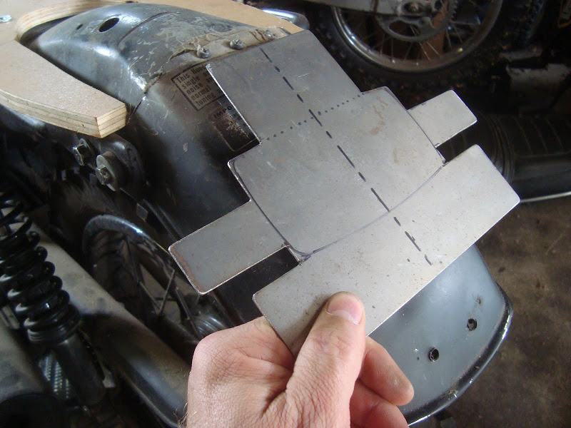

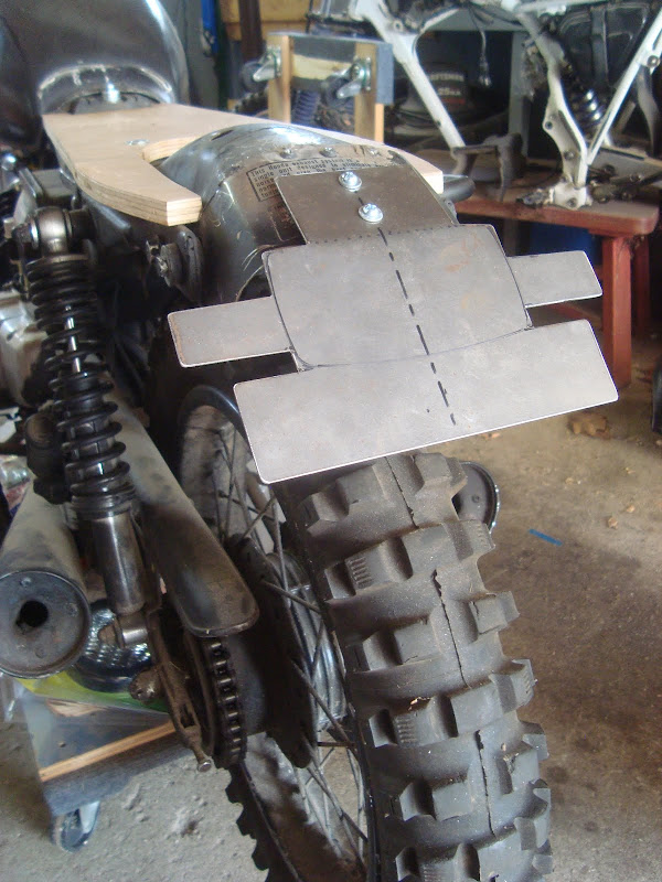

Then to start working on a taillight bracket:
Today I managed to finish the bracket, get the lights mounted, and do the wiring. The wiring isn't as tidy as I'd like, but I'm eventually planning on ditching the airbox and making a shallow tray under the seat to house all the electronics, I figure I can re-do some things then.
Cost-wise, the plywood and steel for the bracket were scrap I had laying around. The taillight was $8 and the turn signals were $4 each. Figure maybe $10 for the t-nuts, assorted hardware, wire and connectors. You can see in the background of that last picture the foam I bought for the seat. That and some batting set me back $15. So all told now I'm up to roughly $250 spent. That's half my budget!

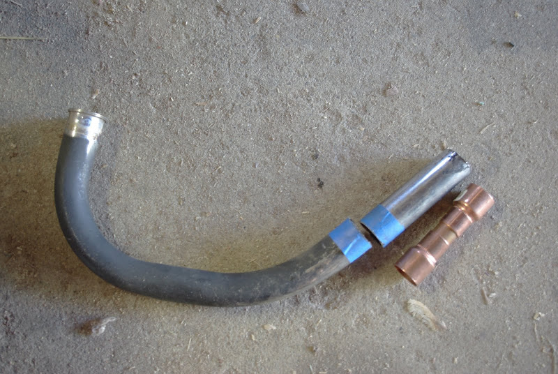

The mufflers were big, heavy, ugly, and rusted through. The idea was to cut them off and build baffles right in the header. Once we had the mufflers cut off though we found that the entire exhaust was double-wall tubing. That meant we had to cut another chunk off of the header to get the inner tube out to make room for the baffles, then I'll have the headers welded back up.
I'm making the baffles out of common copper plumbing parts, a couple of reducers and a short length of pipe. The pipe will be drilled and then wrapped in steel wool before being installed. But you get the idea.
Getting rid of those mufflers meant we could also get rid of the big brackets that carried them and the passenger pegs. The starter was disabled when I got the bike (think melted wires in the headlight bucket, and the wire from the starter button snipped so that no one tried to use it), so why carry the extra weight of the starter? And then of course you don't need the starter cable, or the relay...here's most of the weight that we shed (one muffler and the starter cable had already made it into the recycle bin).
