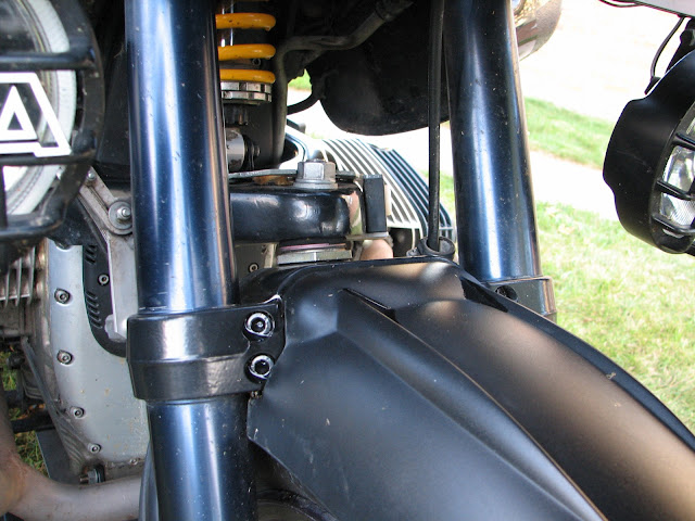

Claude and CSM have sent me on my way and I'm learning, I've had my rig home for about 2500 miles and have adjusted it this and that and am back almost to where I started.Its hauling my dog and I and or insignificant other around pretty nicely, mostly neutral steering, enough power (there's never really enough) and even managed 32 mpg in the Coulees in the Mississippi River Valley ( greatly surprised).
My 04 GSA I've owned since new with 81k as of today,set it up with a 32/11 final drive from an RT for just a touche deeper gearing and welder buddy whose shop I hang out in all winter did a Dedone style trail reduction (thanks to inmate Twintwin) we shortened the front A-frame Telelever 3/4" and extended the ball joint mount (Lower triple clamp) 3/4" to leave the fork in the stock position yet change the trail, it seems to not need allot of spring as I'm only up to Ohlins # 12-58 and no bottoming yet.
The stuff laying next to it is soy beans as part of my learning curve was to overheat a rt turn and opt for the bean field (sorry Claude, I didn't apply what I'd learned) .
The real fun in picking this up was going for a ride with Claude, him in the Red Baron me on this one, having been around the stock car dirt track business a bit years ago I was not surprised when he was off like a shot and I was working like a dog to catch up. Claude raced sprint cars and a guy I used to help always swore southern circle track racers only talked slow (Claude's from Florida) once they are on or in their particular foil they are no longer charming bubba's but men looking for the edge of traction.It was fun, I'd never would have gotten going that well without someone

Any chance you got some close-up pics of the work you did to the A-arm? And can you explain how shortening one side 3/4" and lengthening the other side 3/4" changes the trail because I can't picture it in my mind.
http://advrider.com/forums/showthrea...ghlight=Dedone
Drone
Think of it this way : a straight line through the two ball joints(one at each fork clamp) too the ground is your steering head tube angle or frame head tube angle (telelevers don't have head tubes), moving the lower ball joint back steepens that angle changing the trail.Trail being the difference between where that line touches the ground and a line dropped from the axle center line touches the ground.
Lengthening the lower clamp leaves the fork at the stock angle and just steepen the steering head angle. It works well, Claude liked it, we used parts off ebay the R1100 would be even easier due to the way it attaches to the fork sliders.Given I'm retired and help out in a welding shop all winter it was way cheaper and allowed me a Stroker rear wheel budget wise.After steeriting the 83gl1100/ural setup I tried last year(worked great) I didn't like the way it lowered an already too low a bike.
Had I not sunk the front,and dragged the oil sump in a frost patch on a gravel road early this spring, I'd still have that bike.DB
You'd never know the telelever had changed they're not usually black powder coat, and the profile of the bike is exactly the same thanks to Twintwin who I noticed had an r1100gs with the mod done by Dedone a French sidecar builder discussing it in another advrider thread.Thanks Didier !

Very nice setup Dave, and glad that the Dedome style trail mod works for you.
For Drone, drawing from Dedome website, explaining how the trail reduction on the BMW with telelever is achieved.
Sorry it is in French, but basically the drawing shows you how your can reduce the trail without changing the angle of the fork and the position of the wheel. The OEM trail is130mm, and with the Dedome mod it is reduced to 45mm
If you need some translation, I can do it tomorrow.

Even with that explanation, I still had to grab pen and paper and draw myself a picture. Which worked--I now see how it works! But, if my drawing is right, then all of the trail reduction comes from the fork clamp mod, and the A-arm mod solely acts to restore the forks to their original rake angle. Is that right?
And, the big question is--how WELL does it work?

trail mod
Drone
I think we can say the goal is to reduce trail and retain the stock angle (ride height) lengthening the wheel base by changing fork angle is going to change the lever angle compressing the front spring, which is why I liked this plus I personally have less than $300 in it in parts and powder coating,the welder and I collaborate but neither of us knew much about sidecars, allowing me the rear wheel purchase.
I have only ridden 4 sidecars in my brief career a Ural at a dealer demo, my 83 wing/ural with Steerite, Claudes Red Baron and mine, Claude liked it thought it worked as well as his, but he liked my gsa gearing open exhaust and unrestricted airbox and was pretty impressed with the whole thing, so his opinion may be biased.
I couldn't tell any difference in the way they handled except his sat lower not being a gsa and had the regular 1150gs single plug, I'm a little lean a little plugged up blues, which we worked on.
