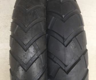

Thread Pattern
The TrekRiders have a chevron thread pattern with good amount of gap in between the blocks. This design helps with the off-road performance by pushing the dirt and gravel away for gaining traction. Also, the chevron pattern continues to the edge of the tire providing good grip for fun in the canyons when street riding.
Avon TrekRider New Rear Tire
