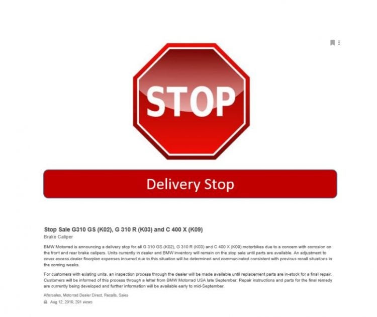

Manufacturer To Dealer Stop Sales Notice
BMW’s Manufacturer To Dealer Stop Sales Notice
Not only have the bikes been recalled but new sales have been stopped until the problem is corrected.  A total of 5,938 motorcycles/scooters are affected.

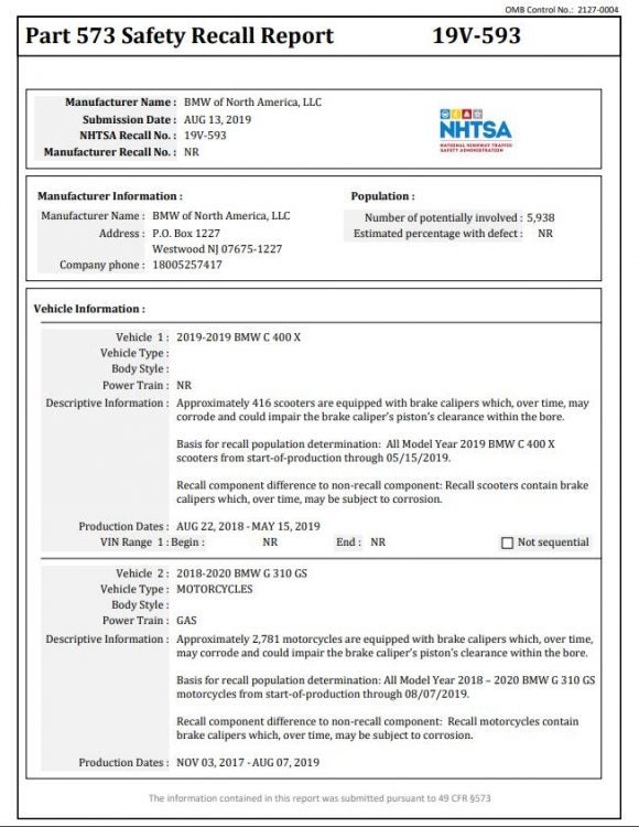

If you’ve ever wondered what a recall notice from a manufacturer looks like, we’ve cut and pasted the NHTSA form that BMW filed.
Part 573 Safety Recall Report Form
Part 573 Safety Recall Report Form.
