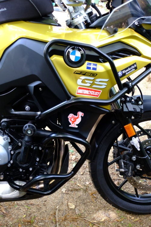

Efficient-looking crash bars should work well, too.
To protect the bike in case of a drop, I chose Wunderlich’s engine and tank protection bars. As you’ll see in the photos, they are relatively unobtrusive but still look as if they’d handle anything you might throw at them – so to speak. A radiator guard goes without saying. So why am I saying it? Because you really don’t want to forget it. Radiators are ridiculously prone to damage, especially on an adventure bike, and they are a total pain to repair or replace.

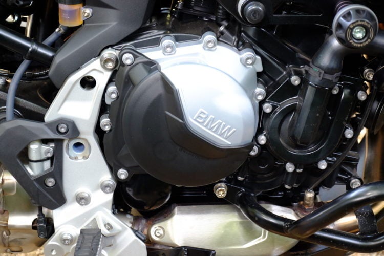

The covers have gaskets moulded into them
Further back, I’ve gone for Wunderlich’s new protective cover set for the clutch and alternator covers. These covers are designed so that mechanical stresses and contact thumps are distributed evenly over the component. There is also a moulded elastomer element made of silicone fitted to the inside to provide additional dampening.

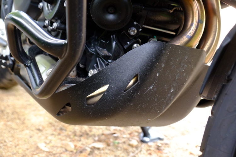

I love good, strong bash plates. No more fear of the dreaded ‘clunk’.
I have a long record of fitting Barkbusters to my bikes; even my Ducati Scrambler has them. So naturally this bike had to have them as well. Barkbusters protect your hands from the cold and from collisions with all sorts of things, and the hand levers from drops. They are an outstandingly well made Australian product and I can’t imagine putting together an adventure bike without them.

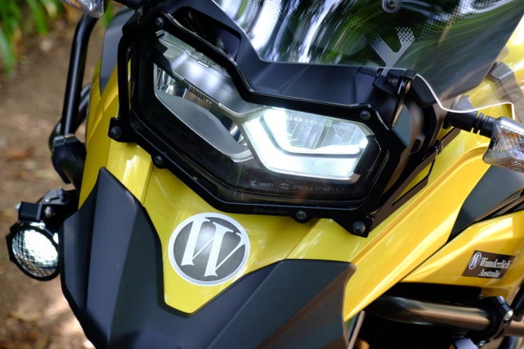

For protection, the most obvious item after the Barkbusters is usually the bash plate. Considering what damage contact with a rock can do down there, that’s only common sense. Wunderlich’s aluminium plate looks as if it came with the bike; I chose the black one and you’d hardly know it was there – until the bike crashes down on the strategically placed rock and doesn’t crush the headers or split the case. I added a headlight protector and a set of Aton LED lights with protectors and grilles.
Apart from the rider, lights are the most vulnerable things on an adventure bike. Protect them!

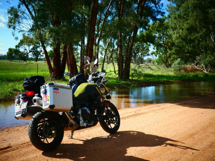

Here’s the finished bike on the road. You will see more of it as I head out to explore.
