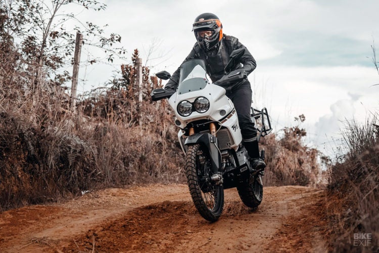

So here’s another, even sweeter reminder of the way adventure bikes were: a delicious 1991 Yamaha XTZ 750 Super Ténéré, from Marco Saldarriaga in Colombia. He’s played his cards right here, keeping the Ténéré’s general vibe, but with a contemporary edge and key performance tweaks.
Marco knows a little bit about adventure bikes. He’s started the grueling Dakar Rally twice and finished it once, and his company, Mastech, manufactures aftermarket dual-sport parts.

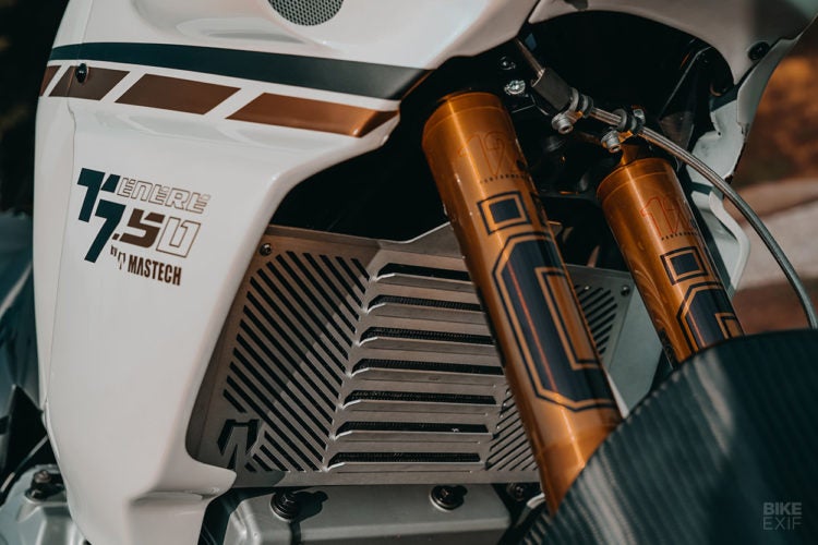

Then it was time to beef up the Yamaha’s aging suspension. Marco grabbed a set of enduro-specific Öhlins RXF 48 forks, and paired them up with aftermarket triple clamps from Off-The-Road in Germany.
The clamps were actually designed for the single-cylinder Ténéré. But Marco made them fit, added a new steering stop, and modded them to accommodate the ignition and an Öhlins steering damper.

The Super Ténéré has one of the most recognizable silhouettes in adventure bike history, so Marco didn’t mess too much with the bodywork. Instead, he retrofitted that classic rally-style fairing with an assortment of modern bits.

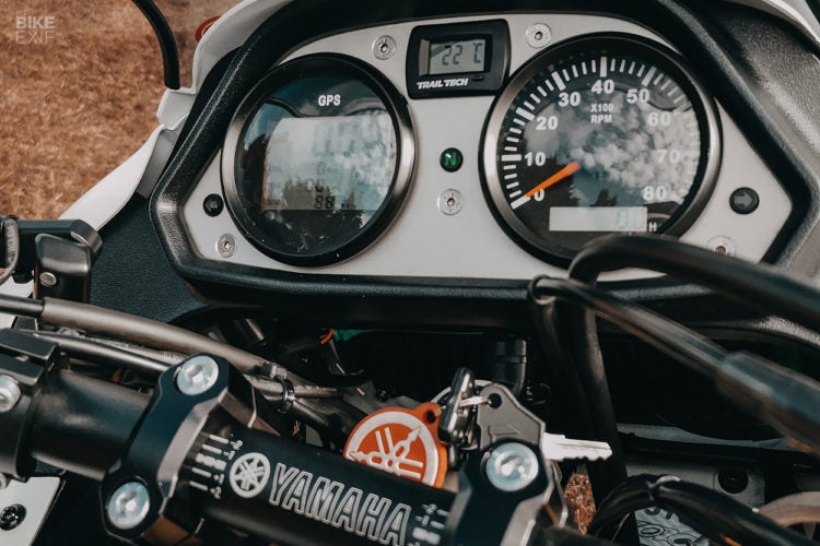

Marco ditched the clunky stock dials, then built a new dashboard plate to host updated electronics. There’s a digital tacho there (which required a sensor conversion too), a GPS-based speedo, and a temperature gauge. Marco’s even added neutral and turn signal indicator lights.
The cockpit also got new, oversized Yamaha handlebars on new risers, modern Yamaha mirrors, and carbon fiber hand guards with integrated turn signals. Lower down you’ll find a slick carbon fiber fender from Perfect Fairings.
A bunch of one-off parts round things off nicely. Marco added a custom radiator guard, engine guard and bash plate, and a rear carrier plate with side case racks. They’re designed to interface with his company’s own hard luggage system.
If there’s still any doubt that Marco’s a man of excellent taste, this Super Tén’s livery should lay it to rest. It’s minimal and chic—a simple white affair with black and bronze accents and a hint of the classic ‘speed block’ motif. (Even the frame got a fresh coat of black.
