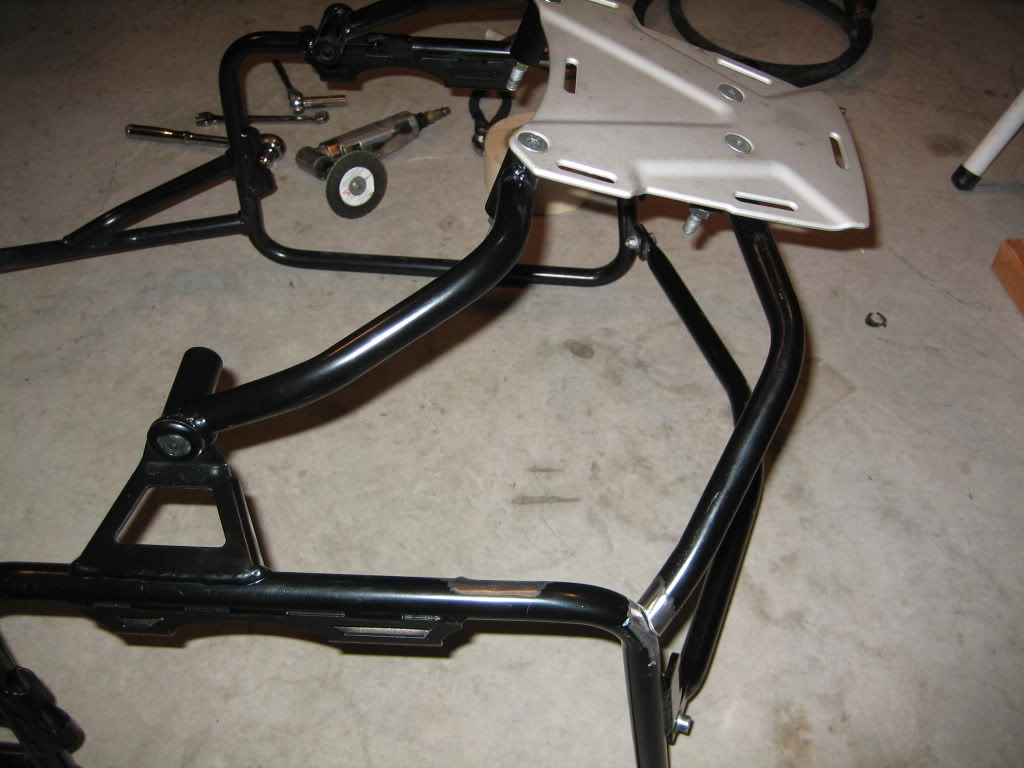

    Many people have said its a real PITA to get their gas cap off of their ADVTANK after it expands. I personally couldn't get the cap off at all and not using the tank was killing me. So I had heard of someone cutting off the bars and flipping them around and re welding them so that you could get to the cap. But I had never seen a write up about it and thought I would show some pics of how I did mine. This isn't going to be a step by step how-too but just some pics and a brief explanation of what to do. Hopefully it helps someone out!

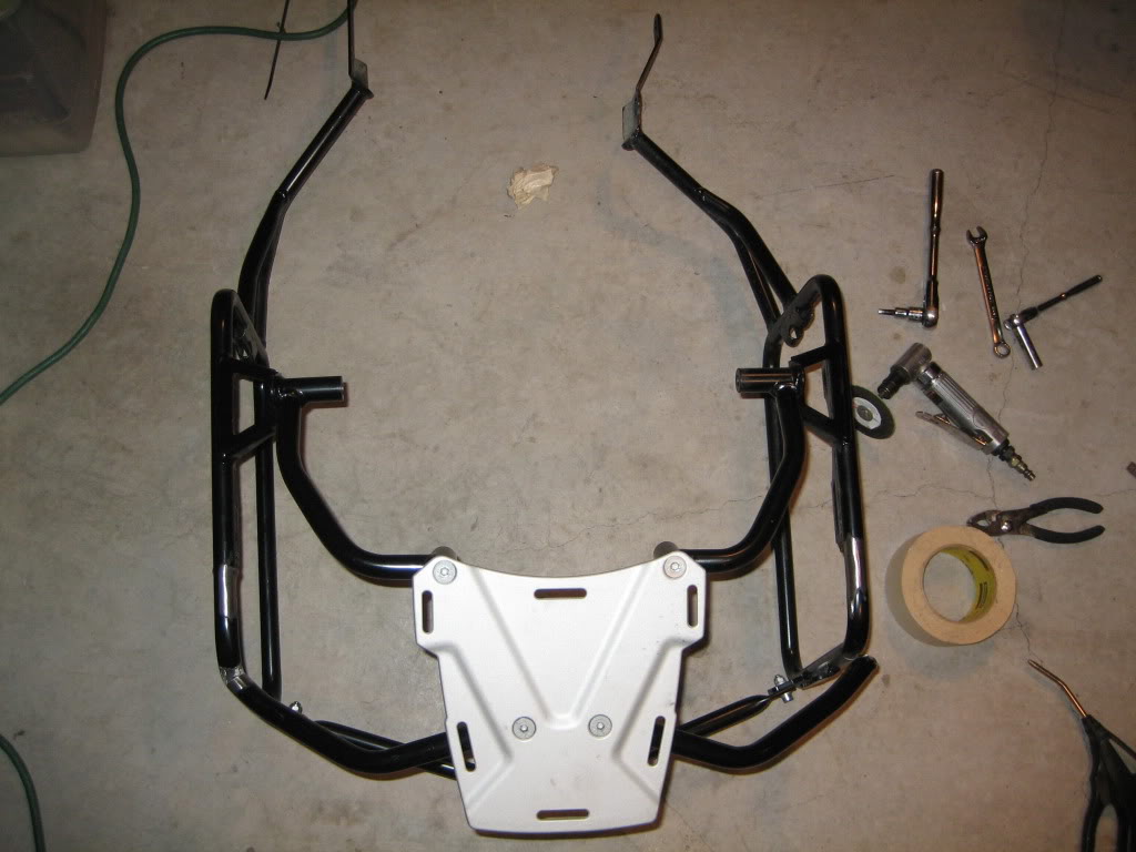

    First I took off the racks and bolted them back together on the ground so that everything would stay in alignment. Then I used a cutoff wheel too cut the top two rear bars off.
    [​IMG]

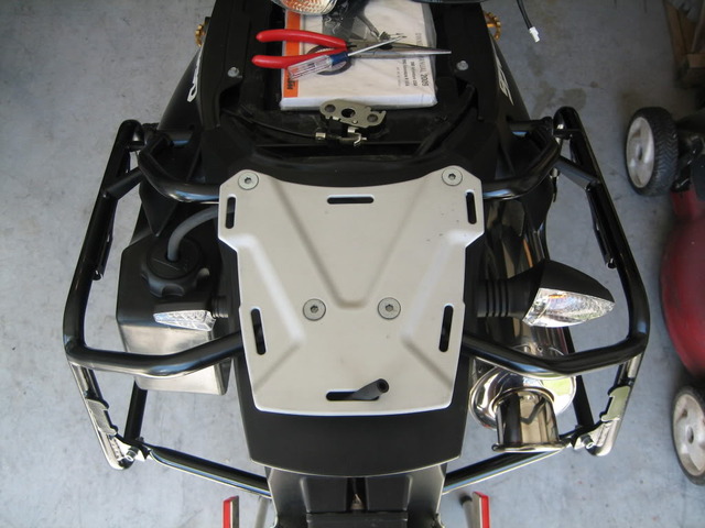

    Next I flipped the bars around and fitted them with a 90 grinder to there new locations. I had to trim off like a 1/4" to get them to meet up equally on both sides. If you have a torch I would bend them a little bit so you can keep your stock turn signals. Otherwise you might have to get some small LED's like I did.

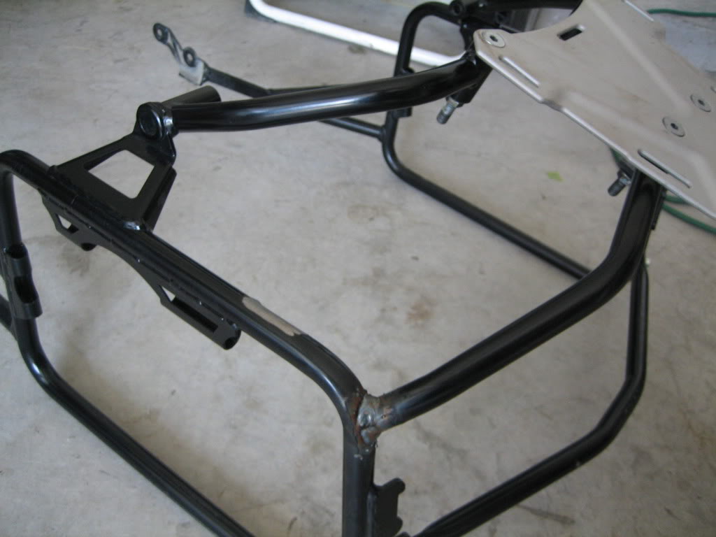

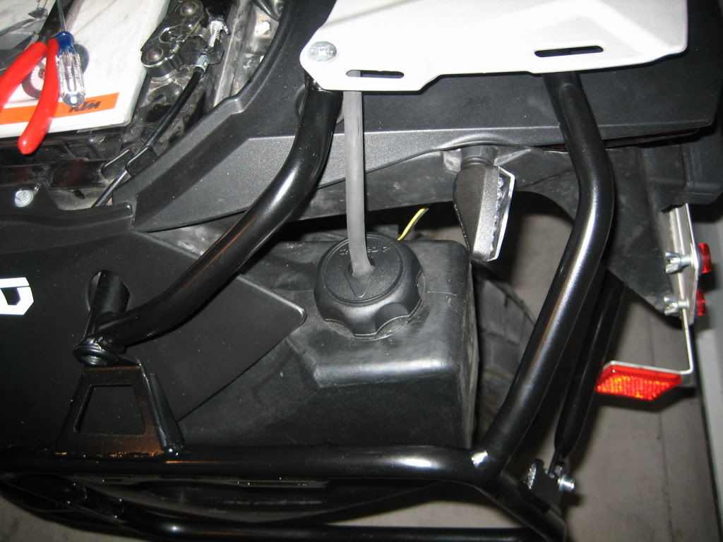

    Then I simply took them to the local welder guy and had them zipped up in less than 5 minutes for $20. Although he tried to only charge me $15 after he found out I was a welder just like him while in the Marines:deal . But I instisted on the original $20 price. They turned out really nice too.:clap
    [​IMG]

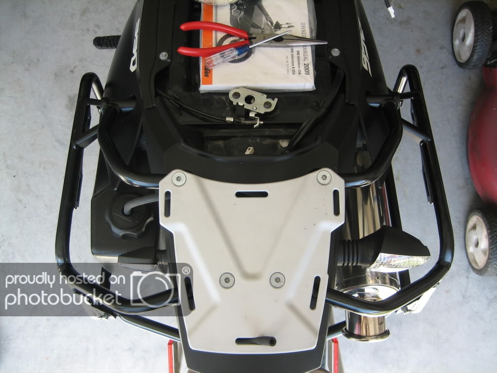

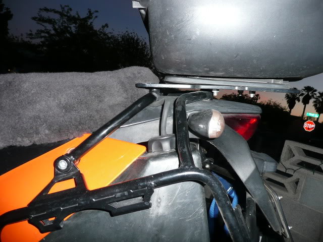

    After welding I just stripped them down and used Rust-Oleum semi-gloss black paint and that was it. You can see how the factory blinkers kinda get blocked by the new bar placement. Although they do fit better than new and bolted right up with no problems with tons of room to get the gas cap off now!:clap

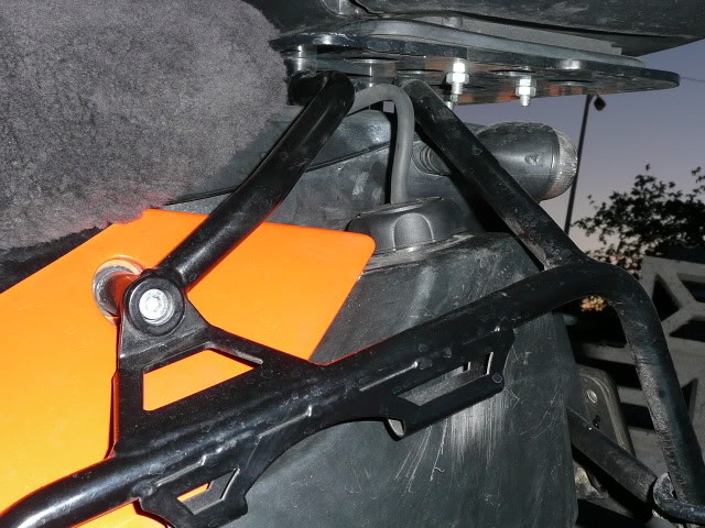

    Hmmn. Rather than flipping both tubes around (which blocks the turn signals) would it not be possible to rotate the left supporting tube (red arrows) and weld to the existing rack tube (yellow arrow) so that it's right behind the turn signal.
    This should give enough room to get the cap off, no?
    I was thinking of just doing it on the left side. It won't be symmetrical but that doesn't seem like a major issue. I'm taking a TIG welding class right now so it seems like a good project :D
    Comments?

    My post in another thread.

    thanks for the pic. so basically same as what I proposed a couple of posts earlier, thanks for confirming it wasn't a bonehead idea :lol3
