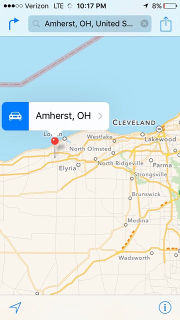

    Just one guy? Surprising, since the KTM main office for North America isn't far from Cleveland.

    It's in Amherst [​IMG]

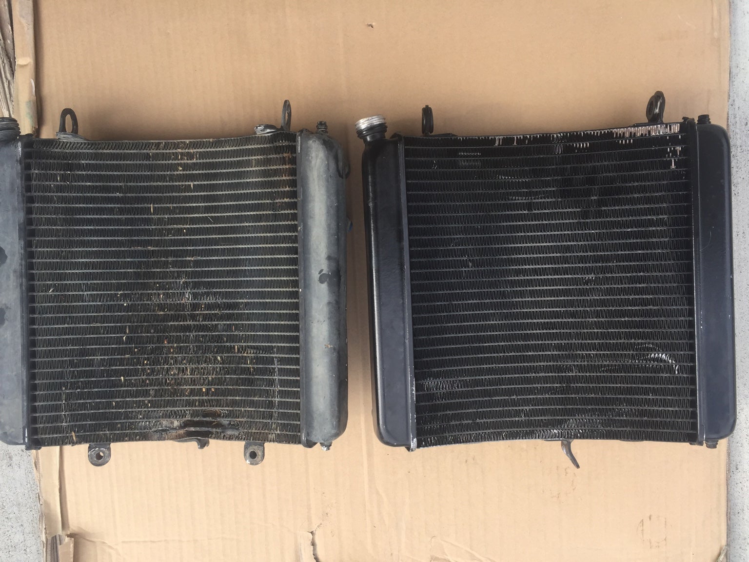

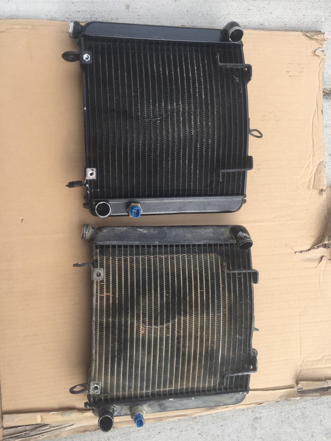

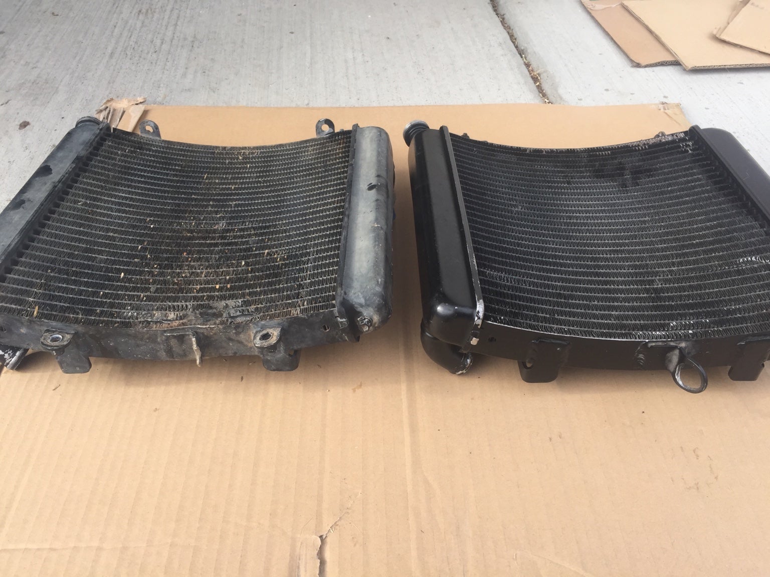

    Okay so I grabbed a 950SMR rad off eBay. After checking the parts fiches for the SE, SM, and SMR there seems to be a few small differences between all three. The SE is the only that has tabs to mount the plastic rad guard but aside from that the SMR is identical, including the fan assembly. I'm assuming the SM would bolt up as well but I don't have in my hands some I'm not 100% sure. My plan for now is to send off my SE rad to Mylar and have them reinforce/repair the rad and use the SMR in mean time. I'm pretty sure I can zip tie the plastic guard in place but I'm pretty much only going to be on the road for the next couple of weeks so it should be fine either way. When I get my SE rad back I'll switch them out and send the SMR rad to Mylar and have them reinforce it and add the tabs to mount the plastic guard so I'll a spare.
    Here are a couple of pics of the two rads, SE and SMR. The shinier one is the SMR rad.
    [​IMG]
    [​IMG]
    [​IMG]

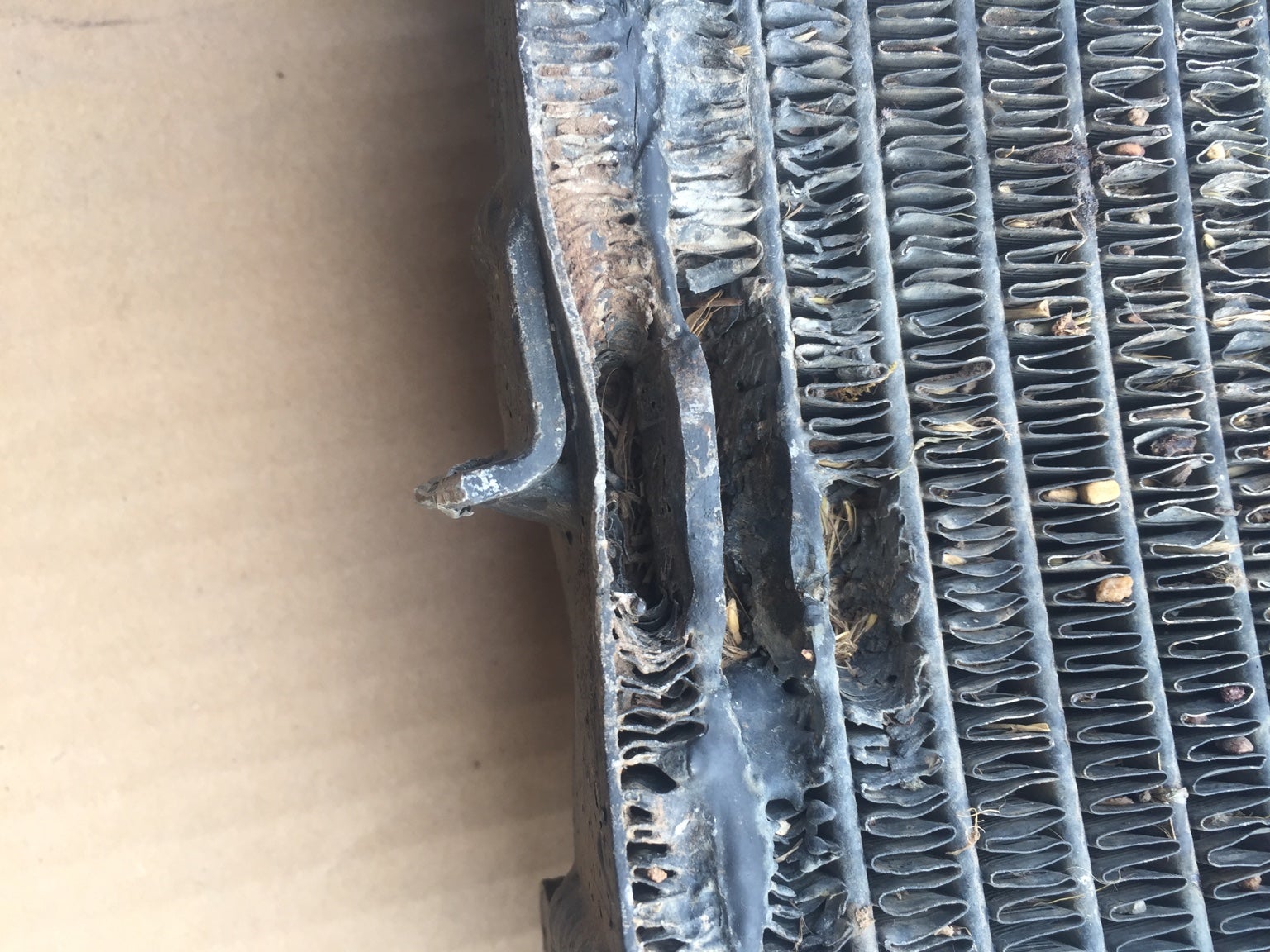

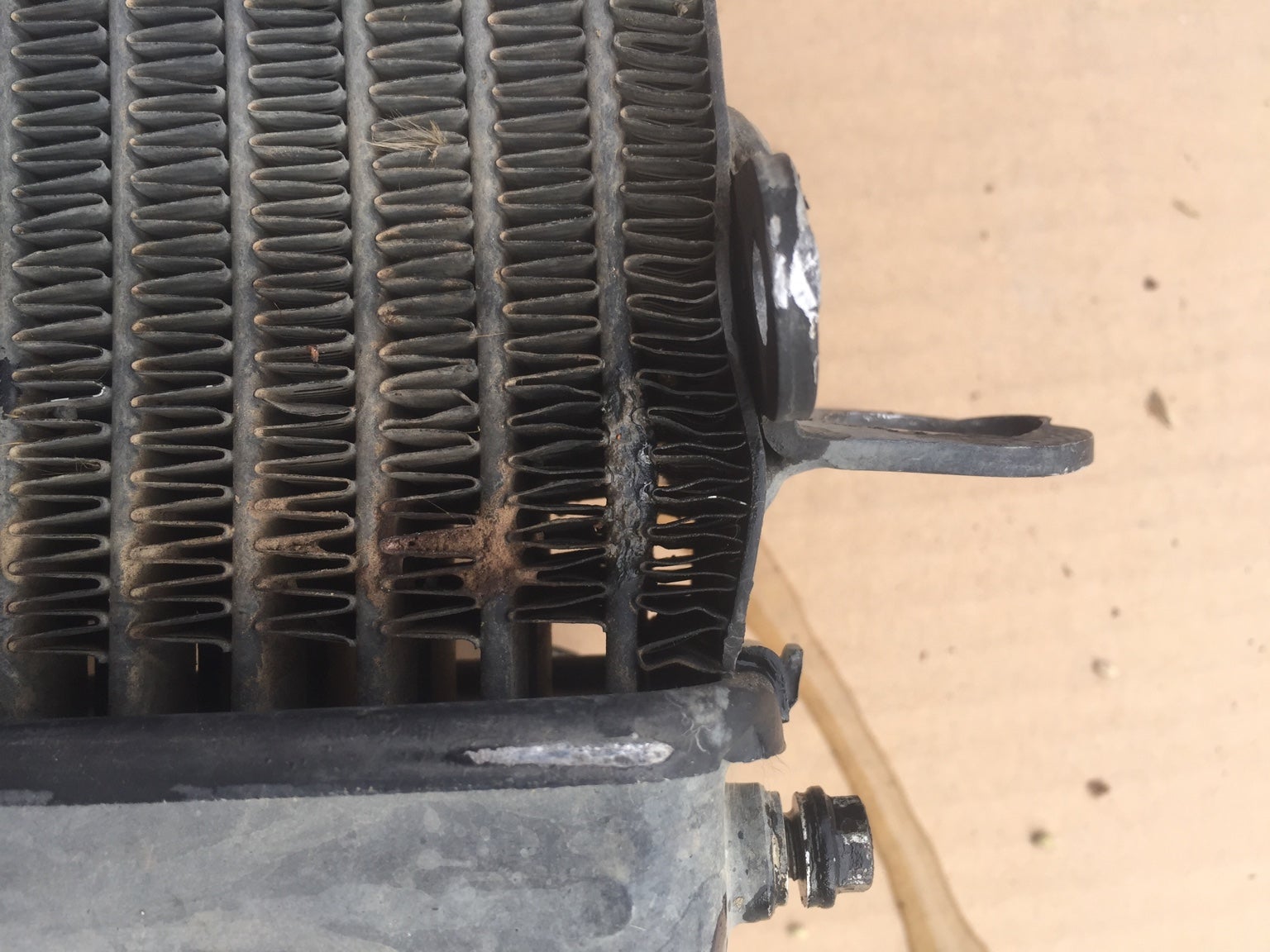

    And here are a couple of pictures of the damage to my old one. I don't think it's to bad.
    [​IMG]
    This had been previously repaired but it left the lower mounting tab vertically worthless. I think this is what caused the upper to crack.
    [​IMG]
