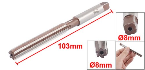

    In the past some riders have found new bushing will be too tight. Not having the proper sized honing tool they have honed the bushing with a drill bit.
    SmittyBlackstone likes this.

    Yes I did this with my bushings as a field expedient method. It worked OK but I picked up this cheap reamer on Amazon for the next Tech day.
    [​IMG]
