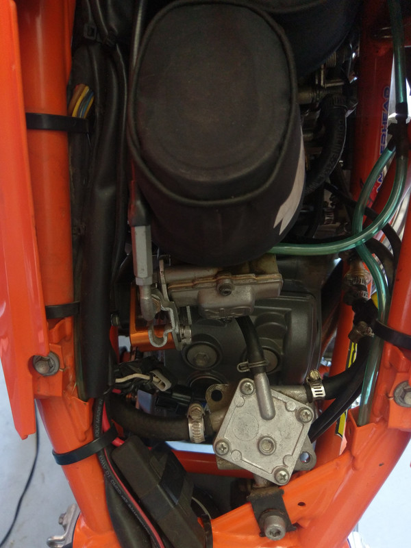

    here some random pic i got
    [​IMG]
    [​IMG]
    [​IMG]
    vacuum line / pulse line i kept same size as the nozzle off the pump (there a wright up on this somewhere on the forum)
    fuel line i run 8mm in & 8mm out (other 2nd outlet from my pump i blocked)
    #74
