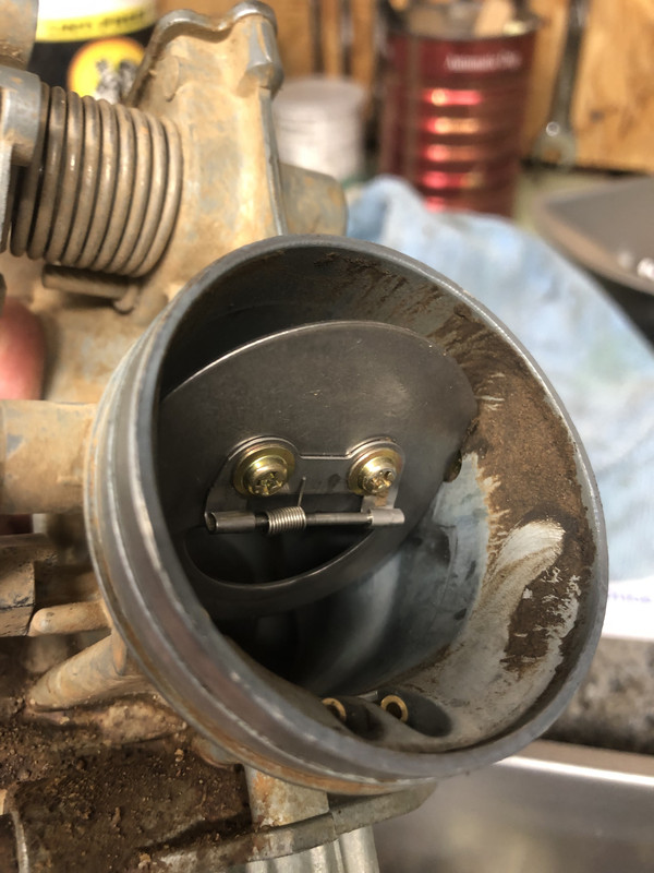

    My stock carb is shot, I'm looking at buying a new carb.
    I want Reliable, Durable, and ease of install because I just want to get back on the bike.
    Should I get XR's only flatside, a TM40 pumper, or a new stock carb?
  2. rustyx
    rustyx Been here awhile
    Joined:
    May 19, 2014
    Oddometer:
    385
    I really like the stock one after you replace the choke plate.

  3. T4EaterJonny
    T4EaterJonny Not too hip...
    Joined:
    Oct 11, 2012
    Oddometer:
    324
    Location:
    Corona, ca
    The low rpm deadspot when you wack the throttle sucks on the stock carb.
