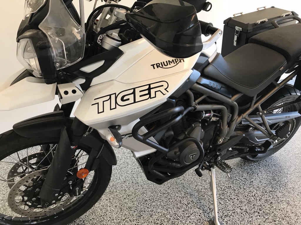

    I just installed these from Outback Motortek.
    #43

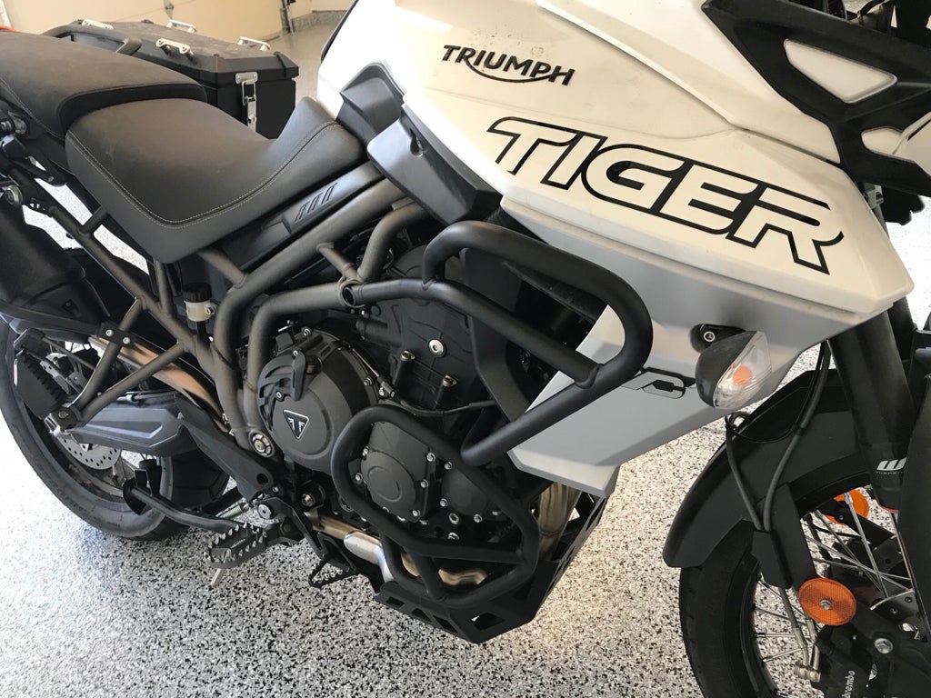

  5. CDBiker220
    CDBiker220 Adventurer
    Joined:
    Jun 5, 2017
    Oddometer:
    36
    I know you were talking to "GreatSteak" but I just installed the Outback Motortec bars as well so I thought I'd post by thoughts. I love them, they fit really well and went on relatively easily. They are definitely heavy duty and feel like a solid unit. I think they are the best compromise between having enough protection and looking gaudy of the bars available which is why I picked them. They look really good on the bike.
    #45
    Lushtrucker and KLEW like this.

  7. GreatSteak
    GreatSteak Adventurer
    Joined:
    Sep 14, 2017
    Oddometer:
    21
    Location:
    Lawrenceville, GA
    This pretty much sums it all up.
    They are solid and much thicker than the stock bars. Left side was a tight fit and took sometime to install but it all went together.
    #47

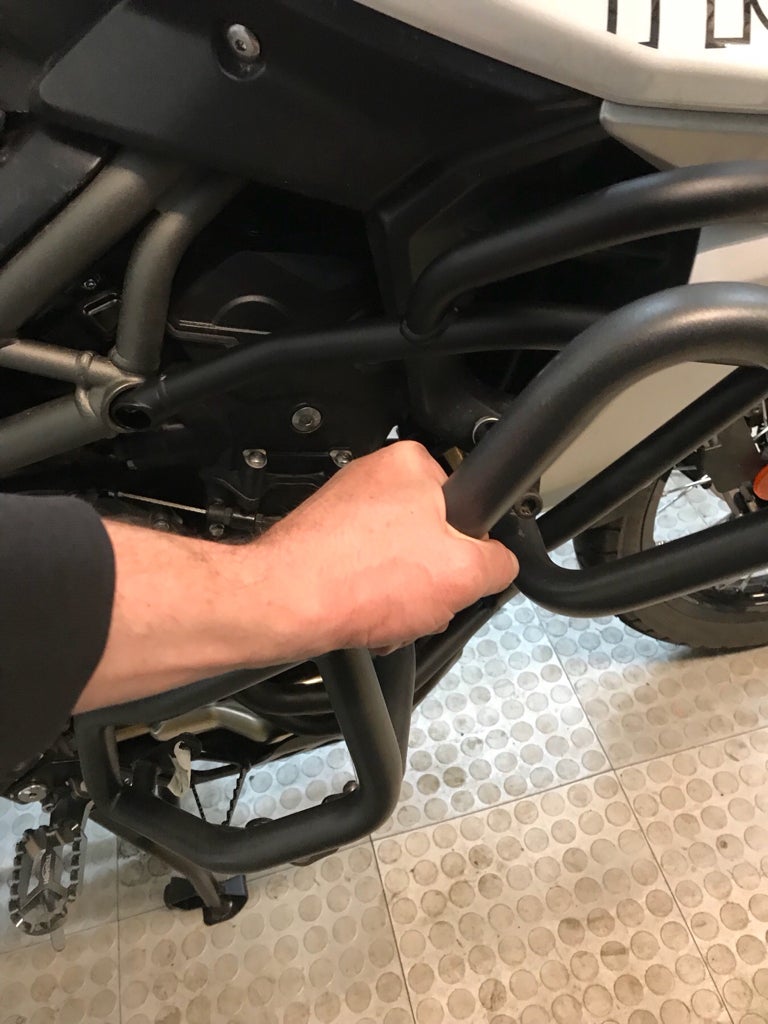

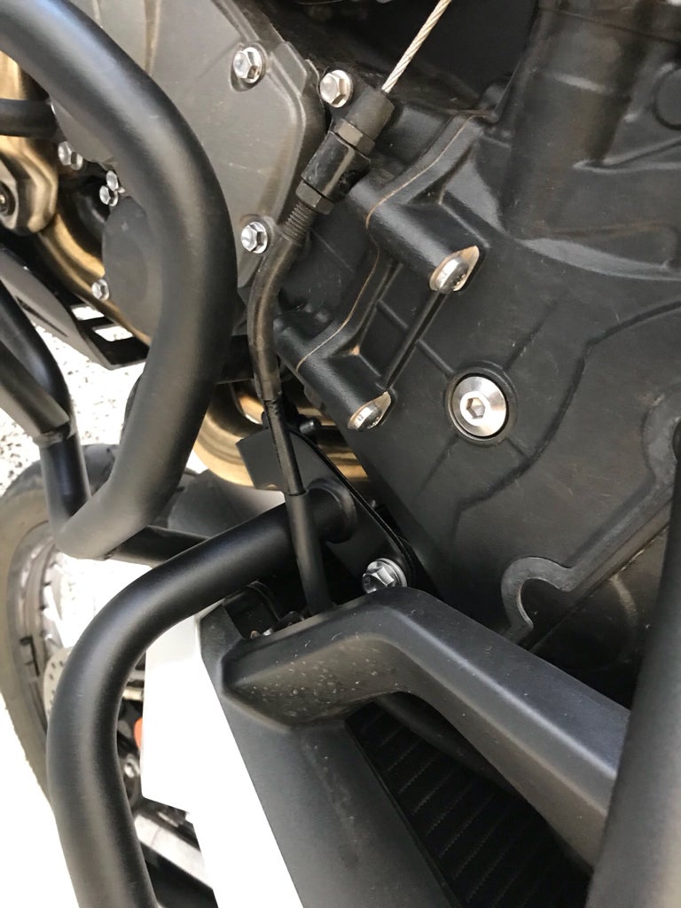

  9. sicario
    sicario Adventurer
    Joined:
    Mar 21, 2018
    Oddometer:
    15
    Location:
    Texas
    Current models come with stock lower bars, Triumph sells upper fuel tank protection bars. I just put on a set.
    #49

  11. sicario
    sicario Adventurer
    Joined:
    Mar 21, 2018
    Oddometer:
    15
    Location:
    Texas
    Total PIA is right MAXATTACK. Wish I had seen your photos before doing the job. Did you notice the instructions have the left and right incorrectly identified. Still wondering why it's necessary to touch the swing arm and frame adjusters. It can just bolt on the front without all that trouble.
    #51

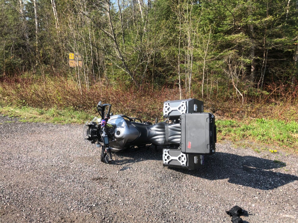

    Adventure Spec bars hard at work. I’m thinking it was a kickstand operator error.
    [​IMG]
    #56
