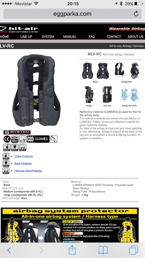

    [​IMG]
    This seems like the ticket right here for me
    zoomcarve likes this.
