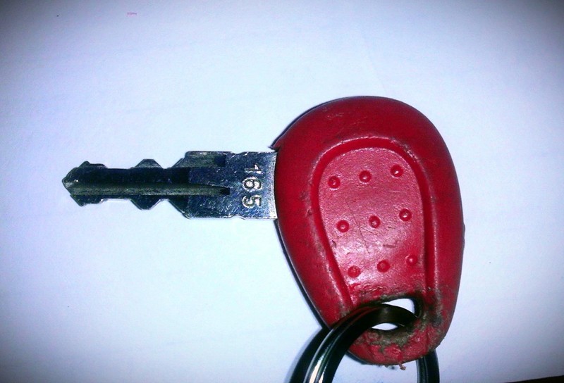

    Another data point. Key #165 which came with the 47 (?) liter top case on my Wee:
    [​IMG]
