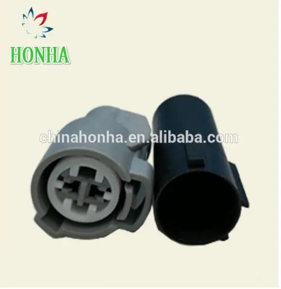

    @WI-790R I've been down the rabbit hole of trying to find the female connector for the IAT, and it appears that Honda uses the same connector on some cars.
    Also found there's some kits to delete/fool the IAT.
    If you search for "2 Pin Female and Male ECT IAT IAC FAN Knock Car connector 6189-0156 Coolant Sensor Connector for Honda" it seams that a female connector indded exists.

    Thanks for the search suggestion. Yes, there are a number of places to find the female connector. It’s the male side that apparently isn’t produced (like is molded into the IAT sensor).

    DOH! I wrote female but I meant male! I never seem to get if the gender is about the shell or the contacts...
    Anyway both connectors exist (BoosterPlug must have found them somewhere)
    [​IMG]

    Cochrane, Wisconsin
    Well that’s interesting! Were there any part numbers listed? I was beginning to think BoosterPlug had a male connector custom molded.
