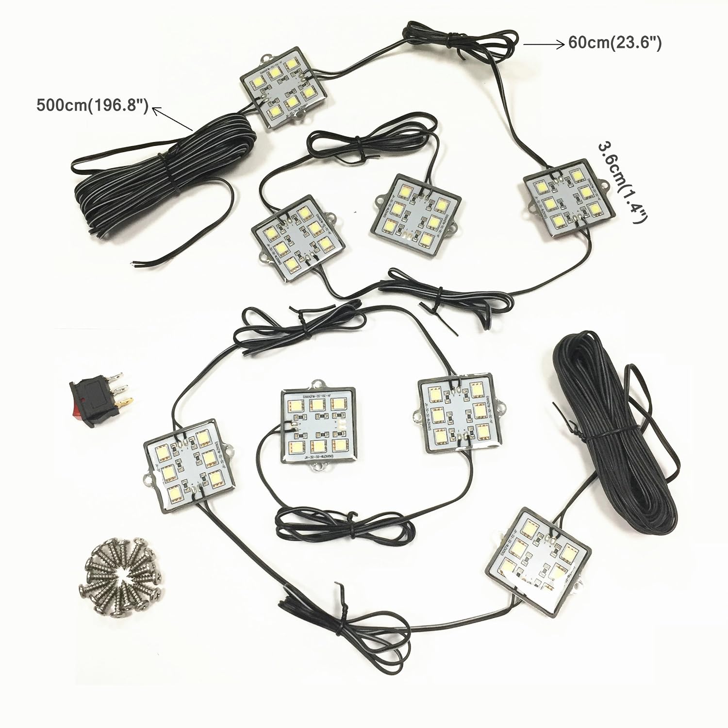

    No pics, but I put 8 of these flat LEDs in the ceiling of my cap. 4 on a switch inside, up next to the hinge for the back glass. The other 4 connected to the manual interior light switch on the dash. Stuck them in place with bathtub caulk direct to the fiberglass. Smeared the wires with caulk also to keep them stuck in place. Left one unstuck. Glued a magnet to the back and coiled up 6' of wire so I can move it wherever I want inside or outside the cap. Nice when messing with the propane tanks on the front of the travel trailer when it is hitched up.
    Wicked bright.
    $21.
    https://www.amazon.com/gp/product/B01KL9NNI0/ref=oh_aui_detailpage_o02_s00?ie=UTF8&psc=1
    [​IMG]
