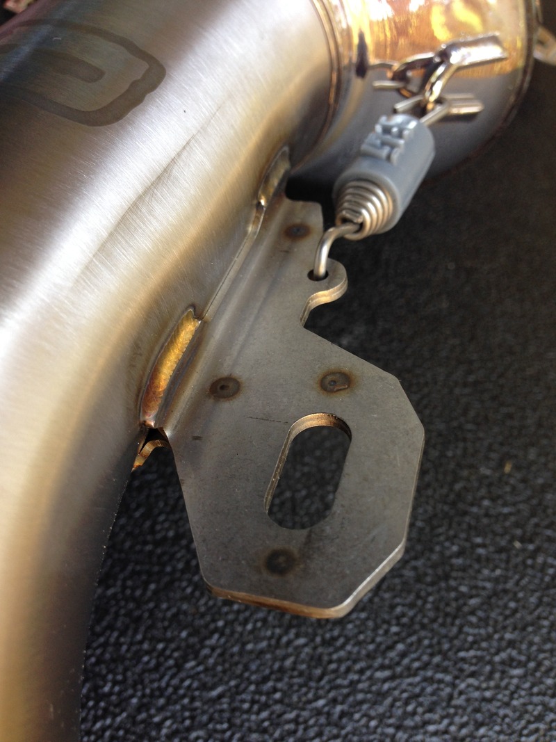

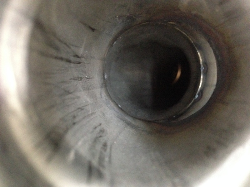

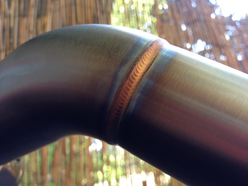

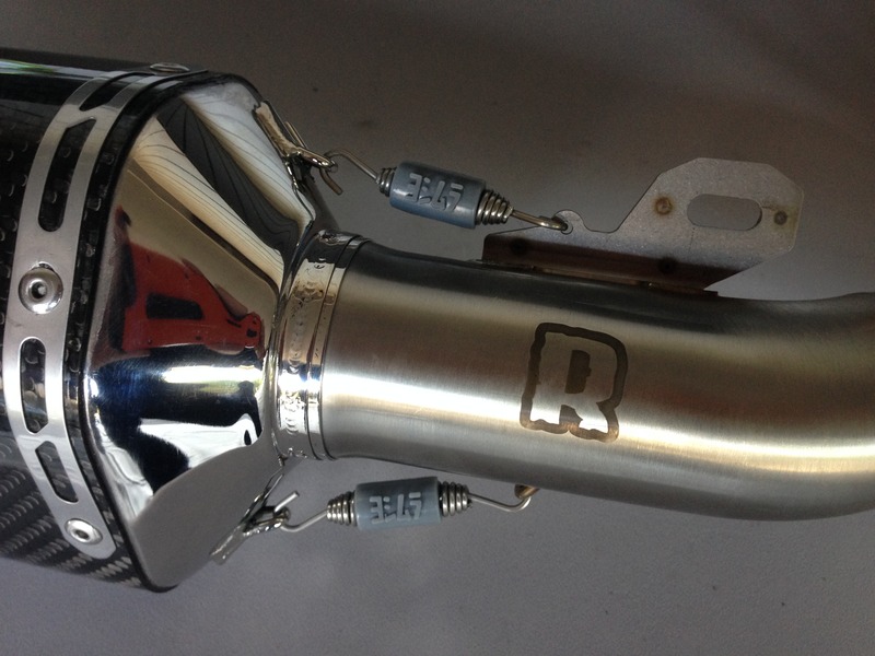

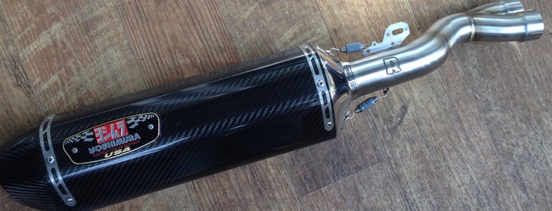

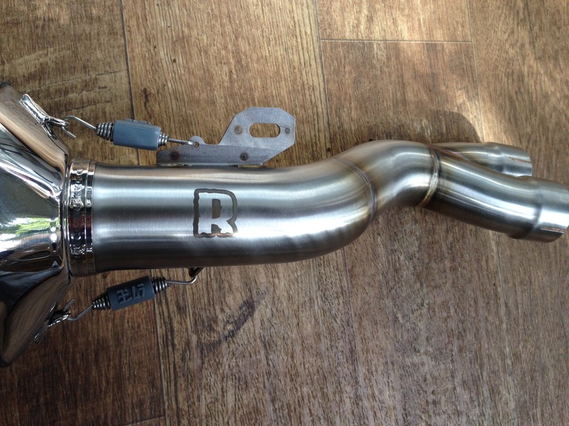

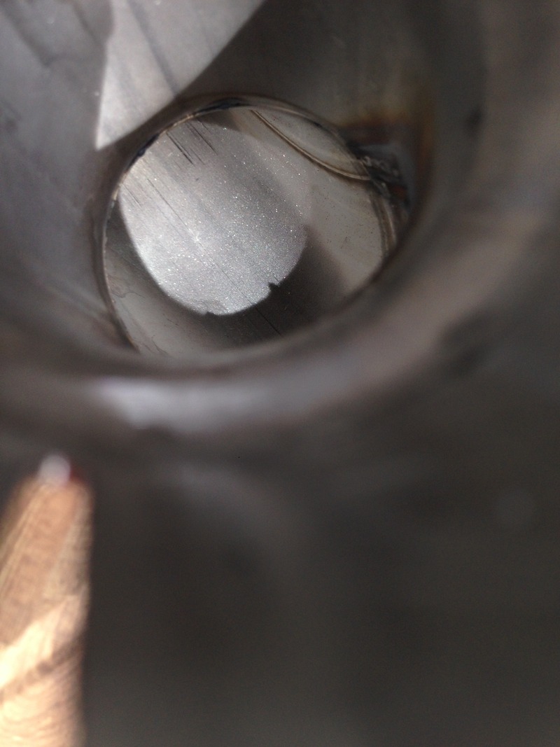

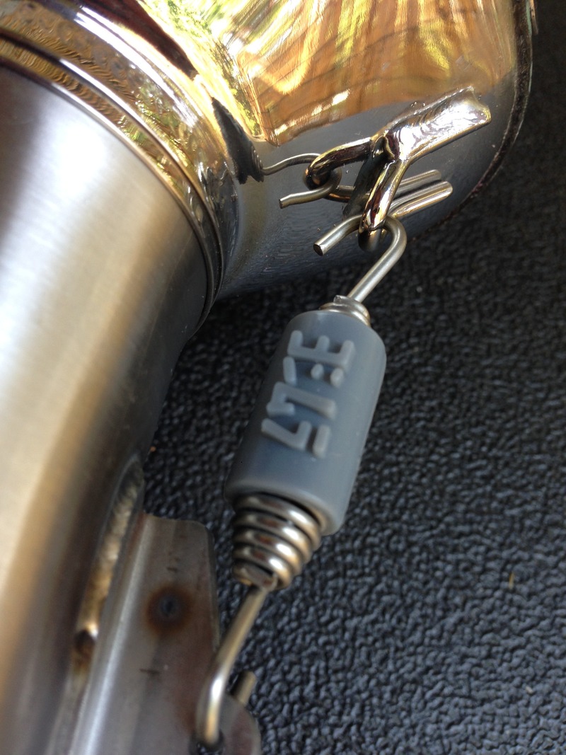

    Well, I got it!!!! Just in time to begin the install process over the weekend. 1st impressions? Very very nice! From the quality of the Yosh carbon to the welds, fit, and finish, it's exceeded my expectations so far....and the welds inside look just a good as the welds outside, so no loss of flow like some of the cobbled together pipes we've seen:
    [​IMG]
    [​IMG]
    [​IMG]
    [​IMG]
    [​IMG]
    [​IMG]
    [​IMG]
    [​IMG]
    [​IMG]

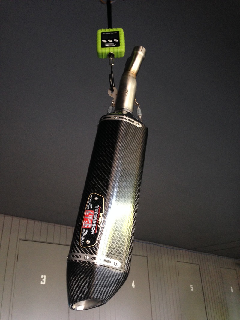

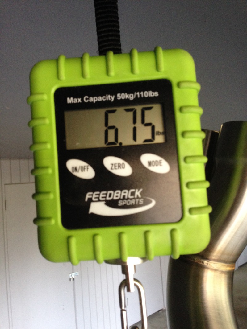

    For those of you wanting to know....I put the pipe and collector on my hanging scale and it's coming in at 6.75lbs!!
    [​IMG]
    [​IMG]

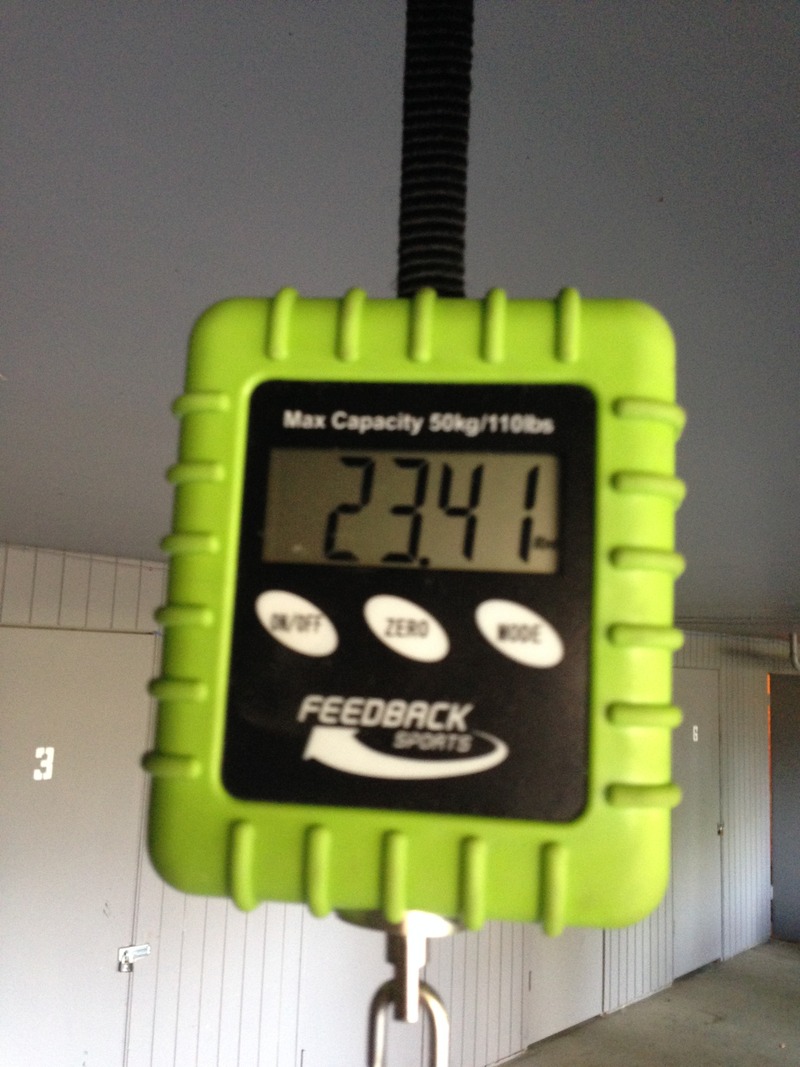

  10. NeptuneTriton
    NeptuneTriton Been here awhile
    Joined:
    May 21, 2013
    Oddometer:
    418
    Location:
    Washington State

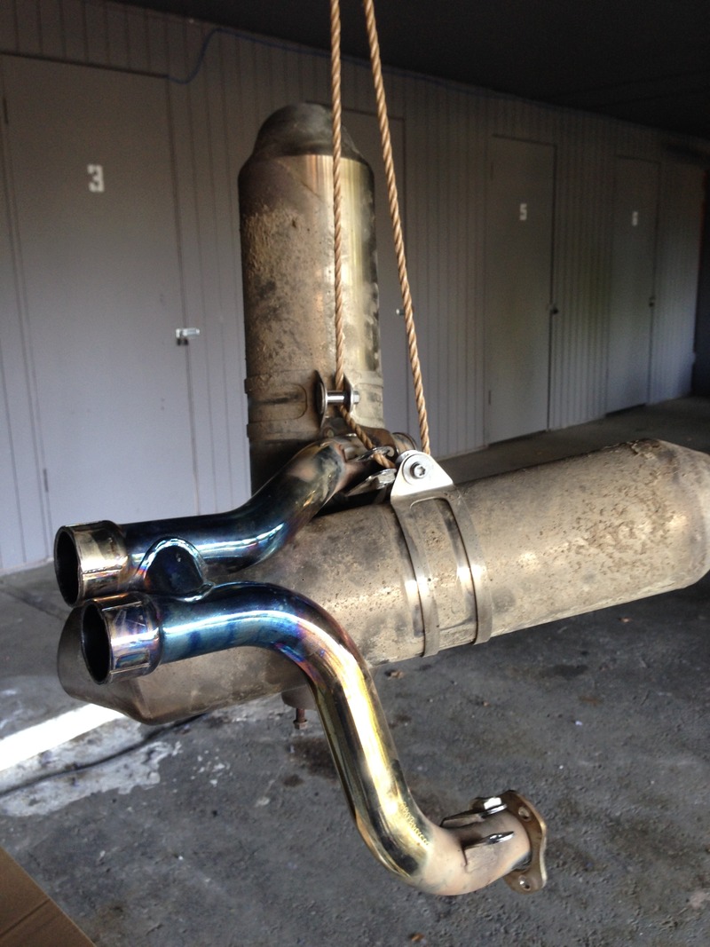

    Compare that to the stock exhaust and stock H-Collector.....a WHOPPING 23.41lbs!!!!
    [​IMG]
    [​IMG]
    #50
