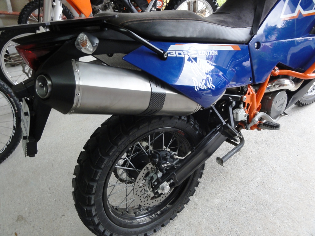

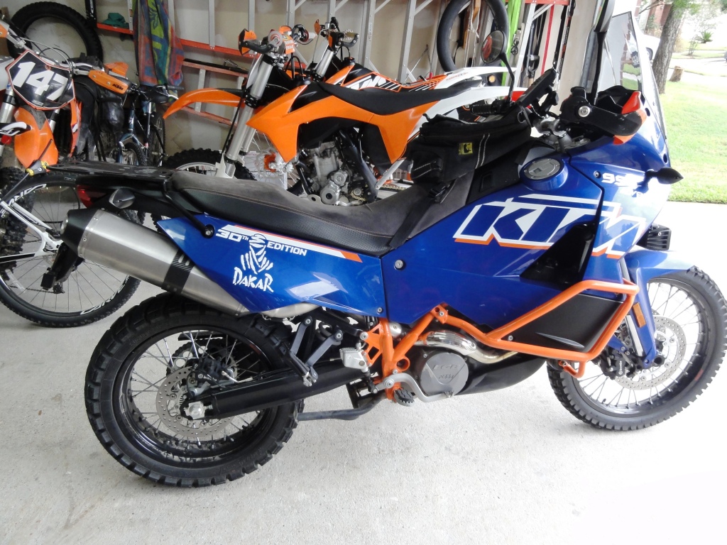

  4. Rsquared
    Rsquared Un-Supervised Slacker
    Joined:
    Jun 4, 2006
    Oddometer:
    190
    Location:
    Texas
    Good thread. I just got mine installed, and on first start up I thought they were going to be too loud. After riding it though, it's just right... I sure do like this bike!
