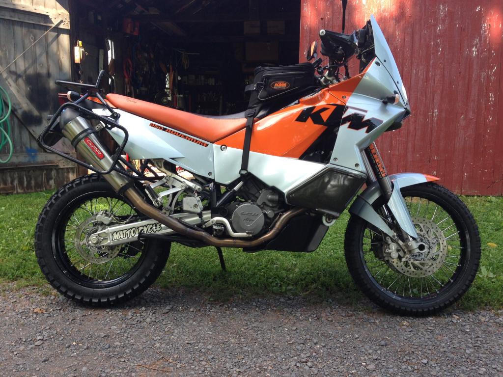

  2. Deadly99
    Deadly99 Fast and Far
    Joined:
    Apr 8, 2008
    Oddometer:
    12,518
    Location:
    Merrickville, Canada
    I bought it from a friend (Flanny). He welded the pipe, the can was an akropovic from a Yamaha R1.
    The pipe gave me lots of stress, too thin, shitty welds, etc. I never got the jetting right either, even with custom jets, etc. Sounded and looked good :D
    Still on the fence about which system to use on the "new" 950.
    #22

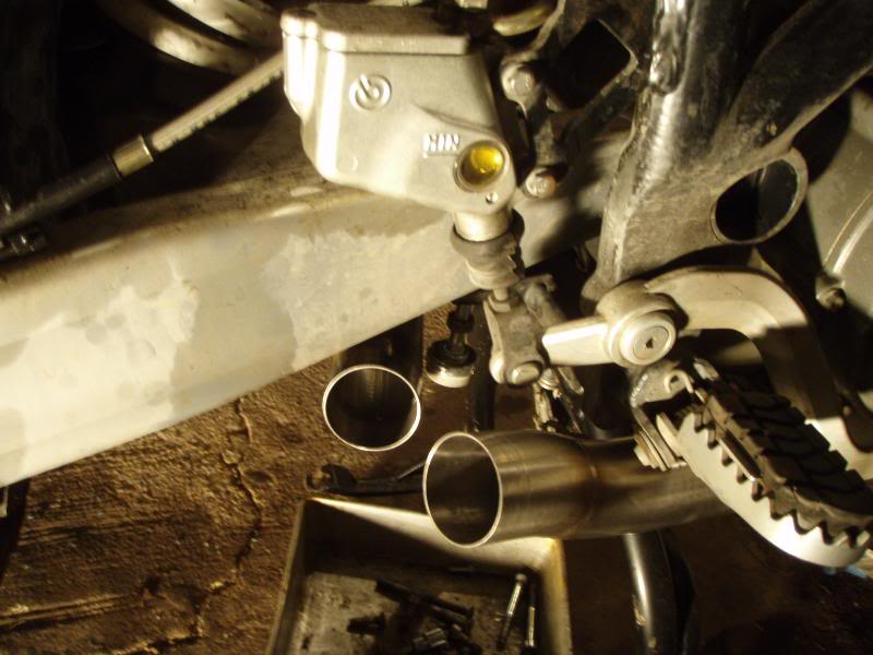

  14. 1stiski
    1stiski Ride that nasty thing
    Joined:
    Oct 23, 2003
    Oddometer:
    1,736
    Location:
    Elizabethville, PA
    I'll snap a pic today and post it up. it can answer your questions.
    This is an old pic of when I was installing the system. Here you can see where the forward header and rear meet,, there is a 2-1 pipe that connects them . I'll grab a fresh pic to show that.
    [​IMG]
    You can also see the rubber bung for the center stand in the center of this photo. (there were two, but due to interfearence , one had to go. )
    #34

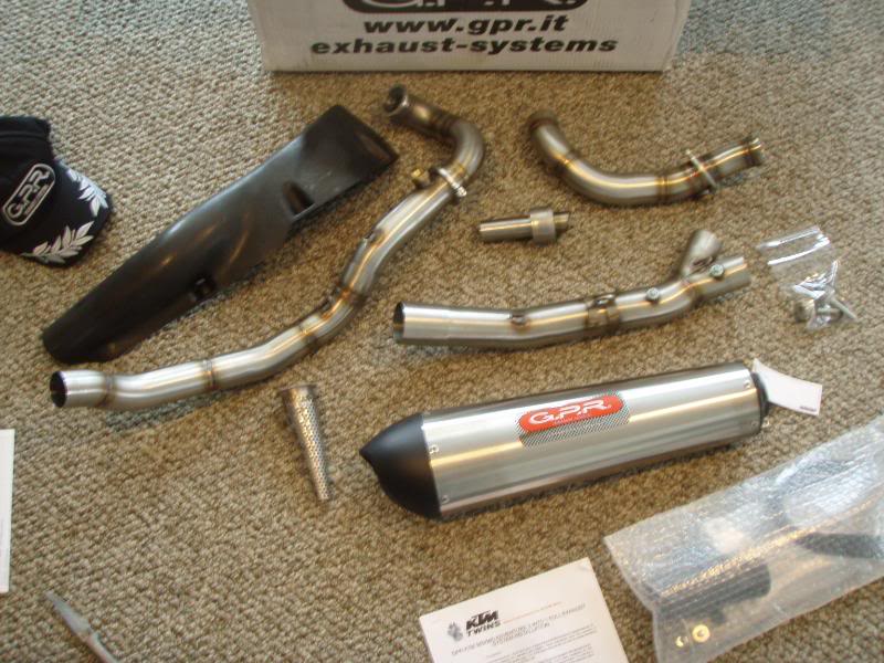

  15. 1stiski
    Joined:
    Oct 23, 2003
    Oddometer:
    1,736
    Location:
    Elizabethville, PA
    Here is the whole system , out of the box and layed out.
    [​IMG]
    #35
