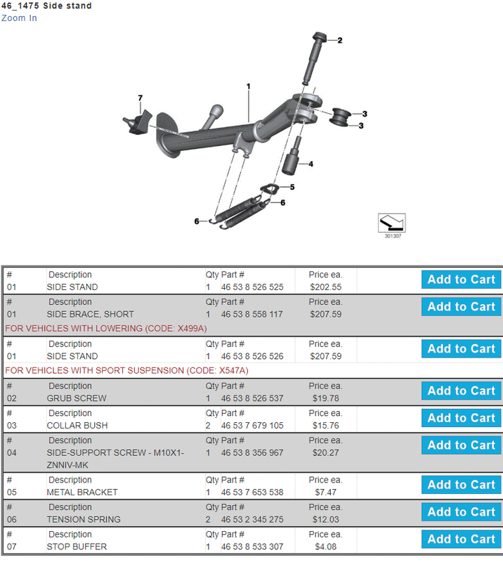

    quick question into the room here: I was wondering why my standard GS is leaning over so far when on the side stand and out of curiosity measured the length of the side stand on my bike, which is a standard, in comparison to the one on my wife's bike, which is lowered.
    The length from just under the mounting bushing in a straight line to the tip of the "plate" (for lack of a better word) is exactly the same: 30.5cm (12 inches). They are also in exactly the same position behind the foot peg mount when retracted.
    Now, the parts fiche shows that there are three different part numbers for side stands: for lowered, standard, and sport suspension.
    I'm wondering whether people could measure the side stand length and post it here with the information what suspension they have (GS, GS Sport, GS Lowered, GSA).
    The reason why I'm asking is that I'm trying to figure out whether my bike or her bike has the wrong side stand. There used to be part (?) numbers underneath, but they are unfortunately not legible anymore.

  17. Lead Wrist
    Lead Wrist Mehr Gelände Weniger Straße
    Joined:
    May 26, 2007
    Oddometer:
    7,102
    Location:
    Zer0-Zer0-Zer0-Zer0
    Per parts fiche, there are 3 different p#s for side stands (this is for '19-'20 R1250GS - haven't checked GSA): std height, low suspension and sport suspension... As it should be...
    [​IMG]
    ETA: GSA side stands are ...117 (same as GS low) and ...526 (same as GS w sport susp) which also makes sense...
    Hope the side-stand mystery is now resolved... :D
    #17
